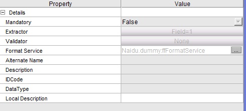

    I suggest to use the format service for the field in the dictionary
    In this service you can implement the complete logic for transformation. In the convertToSTring service you give the corresponding schema.
    Its working when I tested. Let me know if any issues.
