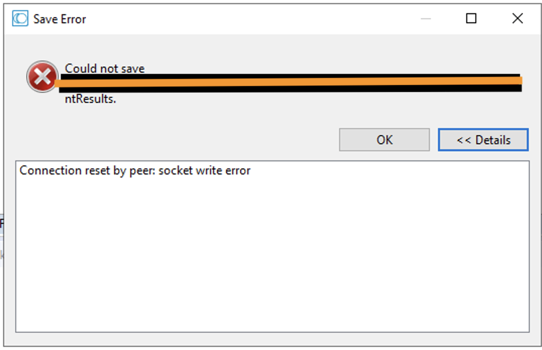

    Hi Folks,
    I am facing issue while saving a simple map step in a flow service. The connection got disconnected from
    designer through error as could not save. Try restoring the session.
    What product/components do you use and which version/fix level?
    Product webMethods Integration Server
    Version 9.9.0.0
    Updates IS_9.9_Core_Fix4
    IS_9.9_Core_Fix6
    IS_9.9_SPM_Fix1
    IS_9.9_SPM_Fix2
    Are you using a free trial or a product with a customer license?
    With a customer license
    What are trying to achieve? Please describe in detail.
    Trying to change and save a simple map step in an existing flow service.
    Do you get any error messages? Please provide a full error message screenshot and log file.
    Connection reset by peer: socket write error. PFA the screenshot.

  • 3.  RE: Connection reset by peer: socket write error while saving the flow service
    Posted 12/03/21 10:14 AM
    Hi @Nagendra_Prasad,
    Please find the requested details below:
    • Designer service development version and fix levels - Where to find?
    • Is the designer and the IS installed on the same machine? If not on the same machine, can you try pinging the machine on which IS is installed from Designer machine and check for any connectivity issues. - No network issue.
    • Any detailed logs on the designer? Window->Show view - Error log. - Yes. !SESSION 2021-11-03 08:13:03.671 -----------------------------------------------
      eclipse.buildId=4.11.0.I20190307-0500
      java.version=1.8.0_222
      java.vendor=*****Systems
      BootLoader constants: OS=win32, ARCH=x86_64, WS=win32, NL=en
      Framework arguments: -product com.webMethods.product.designer.ide
      Command-line arguments: -os win32 -ws win32 -arch x86_64 -product com.webMethods.product.designer.ide
      This is a continuation of log file C:\Users\.metadata.bak_0.log
      Created Time: 2021-11-03 08:13:03.671
      !ENTRY org.eclipse.ui.workbench 4 2 2021-11-03 08:13:03.671
      !MESSAGE Problems occurred when invoking code from plug-in: “org.eclipse.ui.workbench”.
      !STACK 1
    • Any indication of errors on the Integration Server logs. - Yes. [BAC.0002.0000] Wrapped Exception: java.net.SocketTimeoutException: Read timed out
