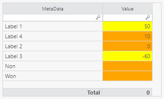

    Posted Mon March 25, 2019 06:11 PM
    Works for me Kyle Kindle.
    Here's the formula I'm using:
          =IF(ABS({Test Cond Format.Value}) > 40,"yellow","orange")
    where Test Cond Format is the table name.
    Here's the result:
    #TBMStudio
