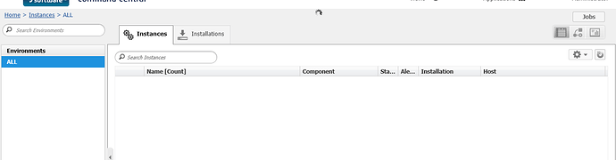

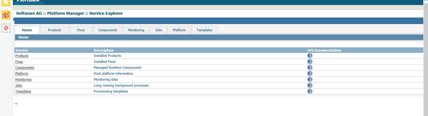

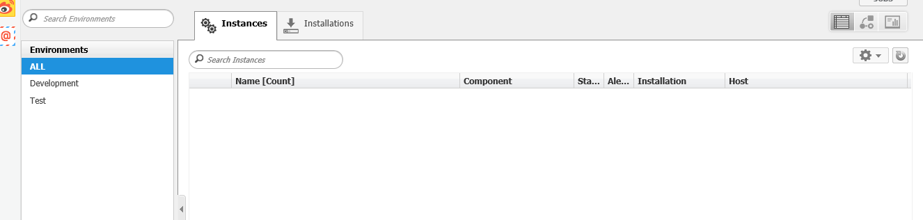

    Dear all
    Do you any one know how to set up the configuration for Command Central?
    I just begin to study the Command central and Platform Manager
    Now I have installed the Command central and Platform Manager and the both task is running .
    But when I open the command cenrtal user interface and there is no any instance at environment page and no any production at installation tag.
    And I can open the Platform Manager page but don’t show any thing.

  • 2.  RE: Command Central and Platform Manager
    Posted Fri February 24, 2017 07:42 AM
    Hi Deng,
    You need to manually add the servers details.
    Go to Installations tab and then add the instances you want to view.

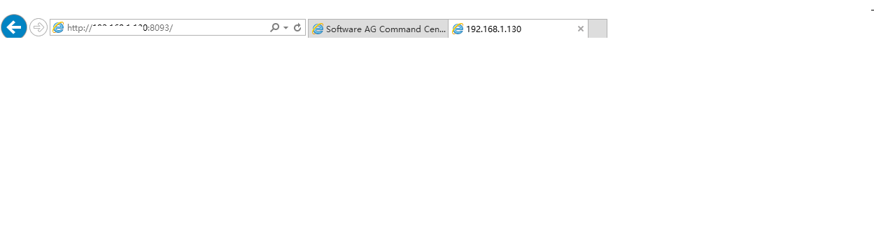

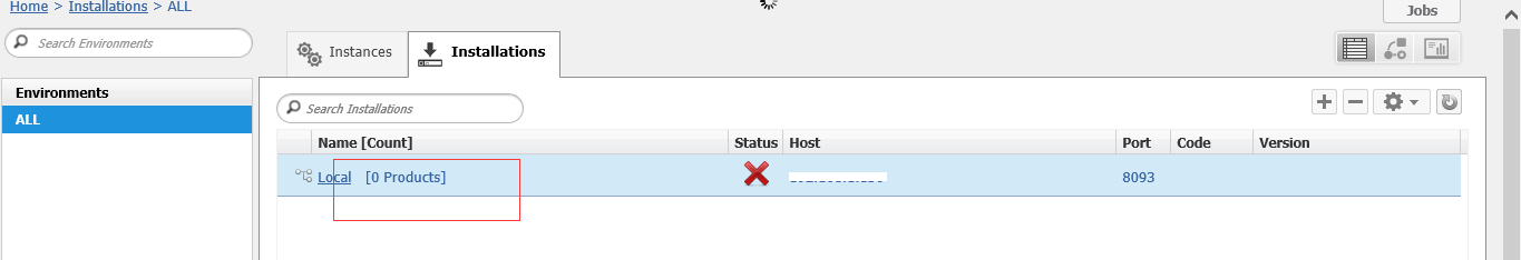

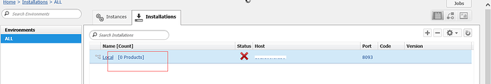

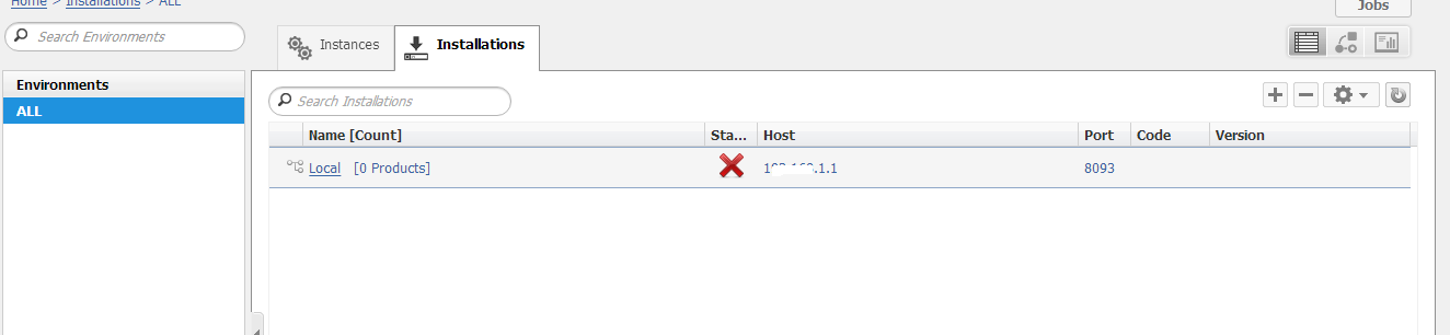

  • 4.  RE: Command Central and Platform Manager
    Posted Mon February 27, 2017 03:16 AM

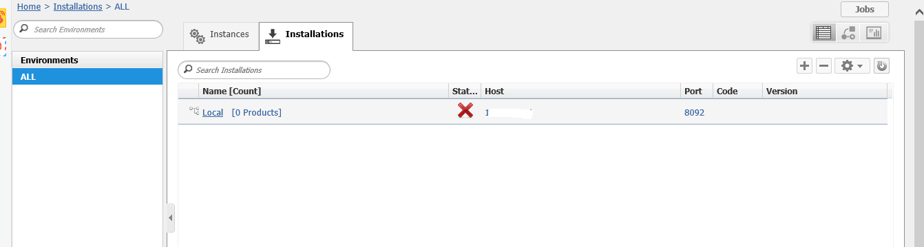

  • 5.  RE: Command Central and Platform Manager
    Posted Mon February 27, 2017 03:37 AM
    Please check if you are able to see a green check in Installation Tab over connection details?
    Can you share the screenshot of Installation tab from Command Central?
    Regards,
    Syed Faraz Ahmed
    #webMethods
    #Integration-Server-and-ESB
    #Command-Central
    #webMethods-General

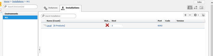

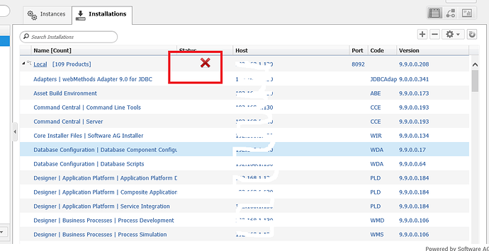

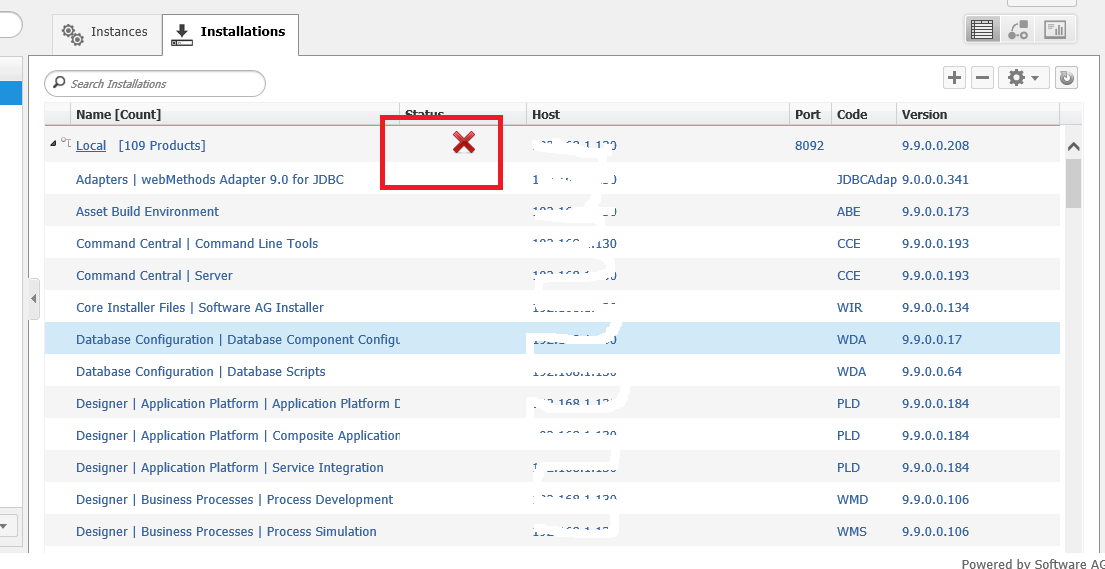

  • 6.  RE: Command Central and Platform Manager
    Posted Mon February 27, 2017 05:01 AM

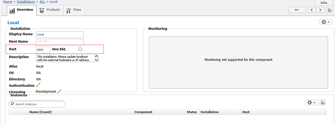

  • 7.  RE: Command Central and Platform Manager
    Posted Mon February 27, 2017 05:08 AM
    Please click on localhost and change the port to 8092 (Instead of 8093) and uncheck the SSL box present on that page.
    Regards,
    Syed Faraz Ahmed
    #Command-Central
    #webMethods
    #webMethods-General

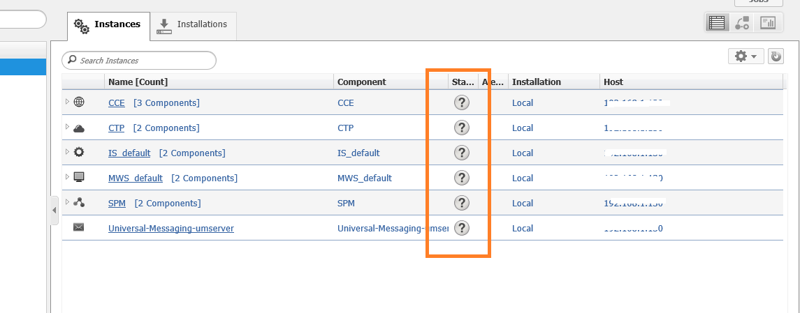

  • 8.  RE: Command Central and Platform Manager
  • 9.  RE: Command Central and Platform Manager
    Posted Mon February 27, 2017 05:40 AM
    Are you trying to connect to lS installed on your machine? or a different machine?
    For Command Central to connect to any IS it needs Platform manager to be present on that particular IS.

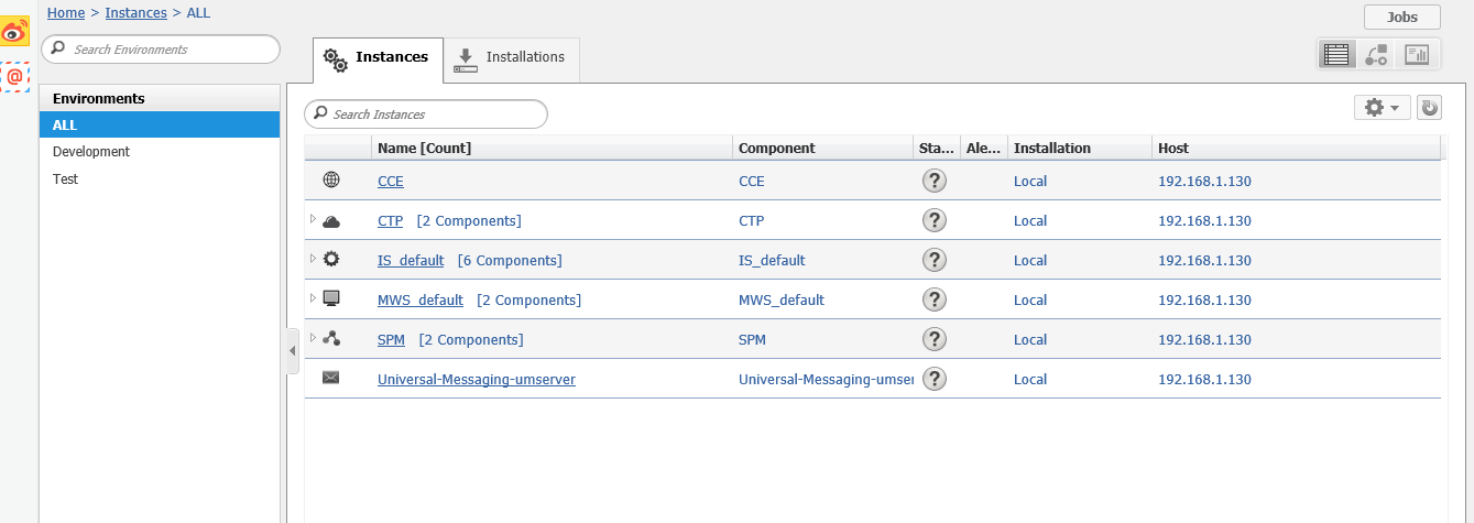

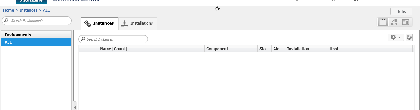

  • 10.  RE: Command Central and Platform Manager
    Dear sir
    After refersh the command central interface pag,I can view some instance and installation.
    Thanks very much for your support!!! :smiley: :smiley: :smiley: :smiley:

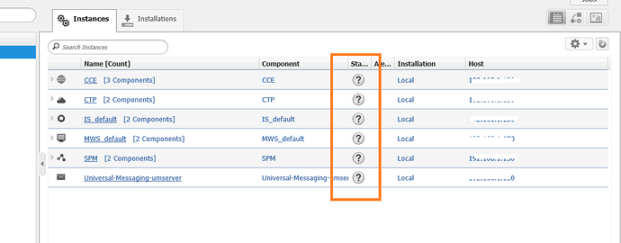

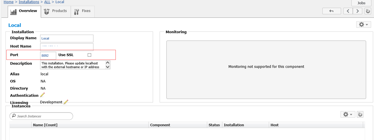

  • 12.  RE: Command Central and Platform Manager
  • 13.  RE: Command Central and Platform Manager
    Posted Tue February 28, 2017 02:23 AM
    Are you trying to connect to your local PC IS? Also, what is the fix level of the IS?
    Regards,
    Syed Faraz Ahmed
