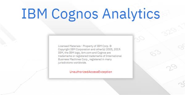

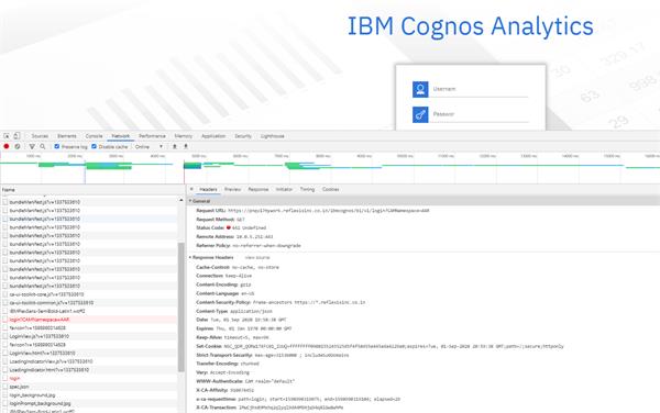

    Hi All,
    With Cognos 11.1.7, we are trying to login through URL where Namespace, Username and password are appended. While everything works fine with cognos 11.1.4, we do get different response in Cognos 11.1.7.
    Cognos 11.1.4 -
    https://<WEBSERVER>/ibmcognos/bi/v1/disp?CAMNamespace=<NAMESPACEID>&CAMUsername=<USERNAME>&CAMPassword=<PASSWORD>
    This URL works perfectly with cognos 11.1.4.
    Cognos 11.1.7:
    https://<WEBSERVER>/ibmcognos/bi/?CAMNamespace=<NAMESPACEID>&CAMUsername=<USERNAME>&CAMPassword=<PASSWORD>
    Can you please help on this issue?
    Thanks!
    Dhanush

  • 3.  RE: Cognos 11.1.7 - Parametrized URL login - Response Status code - 441
    Posted Wed September 02, 2020 06:45 AM
    Hi Dhanush,
    It should work fine, just that when there is still a cookie available to the browser, all secondary authentication requests will fail. Try in incognito / inprivate browser mode and you will see what I am saying. /v1/disp endpoint will work in 11.1.7 as well but if you are going to use bi/ endpoint, pls make sure you set the Glass.urlLoginParameters.
    In Cognos Analytics 11.1.x these advanced parameters can now be added in the portal:
    1. Click Manage > Configuration > System, and select Advanced Settings.
    2. In the key field type: Glass.urlLoginParameters
    3. In the value field type: CAMNamespace,CAMUsername,CAMPassword
    4. Click Apply
    Regards,
    Kiran Passumarthi
