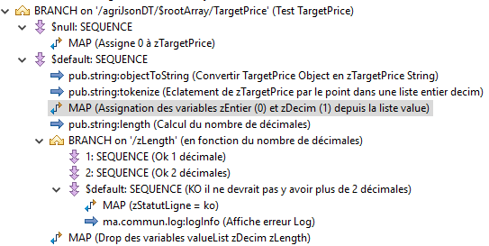

    Hello,
    In my stream I turn JSON into a STRING.
    I have numbers declared as an object that can therefore have values like below:
    Null
    178.0
    178.25
    And sometimes and by mistake:
    0.181 instead of 181.0
    I would like to test that the format of this number has at most only 2 decimals.
    What is the invoke to use for this ?
    This is my current flow in the attached file.
    Thanks for your tips

    Hope this helps, this is another way of doing without regex.
    Say for example the number is 0.181 you can tokenize this number based on the delimiter (.) which will result in two parts
    part 1 = 0
    part 2= 181
    Check the length of part 2 if greater than 2 then do not process this number and continue with other numbers.
    For this, you can invoke string tokenize and branch on the valueList[1]>2
    I checked the code and you are doing the same. Let me know if you have any questions.

    Thanks but how to test the value of the list [2] > 2.
    In my example, I calculate the length of the value [2] and I test in BRANCH /zLength if the length:
    = 1, it’s OK
    = 2, it’s OK
    $default It’s Ko
    Is there a better way ?

    The optimized and best way to do this as below:
    BRANCH (set evaluate labels=true)
    %zLength%<=2 its OK
    $default It’s KO

    Sorry, I’m a beginner on webMethods.
    I have a mistake:
    “Cannot define switch and use label conditions at ’ unlabeled BRANCH '”
    I defined the BRANCH/zLenght with evaluate labels = True
    and 2 sequences:
    1. Label:% zLength%< = 2 (exit on Failure)
    2. Label: $default
      Where do i put% zLength%< = 2?
      Thanks
    #Integration-Server-and-ESB
    #webMethods-General
    #webMethods
  • 8.  RE: Check decimals
    Posted Wed July 11, 2018 05:52 AM
    Remove the zLength on branch and use only evaluate labels to true.
    You have to check service development help guide and get more details. If you need any additional information please reach me on my email.
    #webMethods-General
    #webMethods
  • 9.  RE: Check decimals
    Posted Wed July 11, 2018 06:44 AM
    Thank you very much, it works as you suggested.

    “…optimized and best…” is debatable. :slight_smile: Another way, as noted earlier:
    BRANCH on zTargetPrice
    /\d+(\.\d{1,2})?/: SEQUENCE (Ok)
    $default: SEQUENCE (Ko)
    The regular expression in the branch will match if zTargetPrice is 1 or more numbers, optionally folllowed by a decimal and 1 or 2 numbers. No need for steps to tokenize nor get a length.
    The way you have it in your original post, the way Mahesh provided and this way will all work. I still question the need to do it at all but without the additional info about what you’re doing when the error occurs or is detected by your steps, it’s hard to know for sure.
