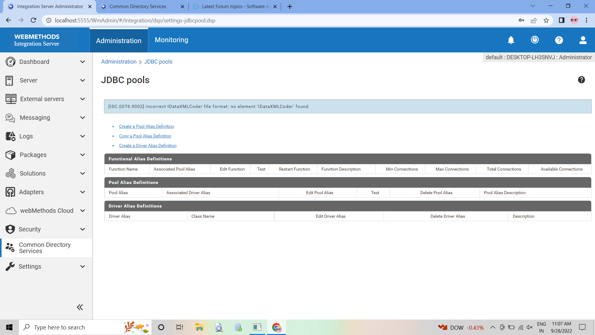

    Posted Wed September 28, 2022 02:04 AM
    Seems like installation is not successful, can you share the install.log?

  • 5.  RE: CDS is not configured
    Posted Wed September 28, 2022 05:21 AM
    The screenshot you have shared is from the Integration Server JDBC pools screen, looks like the JDBC pool configuration is corrupted as well, Can you check the file at \IntegrationServer\instances\default\config\jdbc\pool , and ensure the file is not corrupt.
    Also the installlog shared is from MWS , could you please share the IS installlog from install\logs\installLog.txt as well.
    -NP

  • 7.  RE: CDS is not configured
    Posted Wed September 28, 2022 06:35 AM
    Although I don’t see any obvious errors in the installLog.txt , the other two JDBC pool related XMLs are clearly corrupt with NULL characters,
    Is this the same installation as referenced in Bootstrapping issue to start IS10.11 , if yes then perhaps there are more issues in this installation. I’m afraid you might start seeing more problems later.

  • 9.  RE: CDS is not configured
    Posted Wed September 28, 2022 11:27 AM
    Not a recommendation , more of a hunch, if anyone else has faced this, please chime in.
    If you have a backup of the DB xmls , you can try replacing them , not sure if the same approach as resolving a corrupt Auditconfig.xml will work here . Tagging @Kalpesh_Shah1 for any thoughts.
    If two of the config files are corrupted , probably there are more files with issues. If this is a dev/test environment, is reinstalling in a different folder an option for you?
