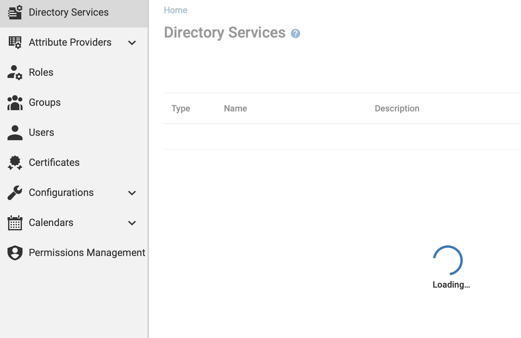

    CDS is installed in our webMethods 10.15 server but could not able to initialize the Directory.
    when we click on Directory Services then it keeps on loading… and never done it.
    Please help here.

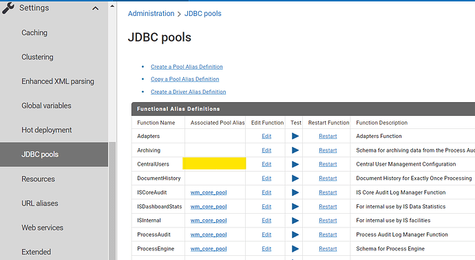

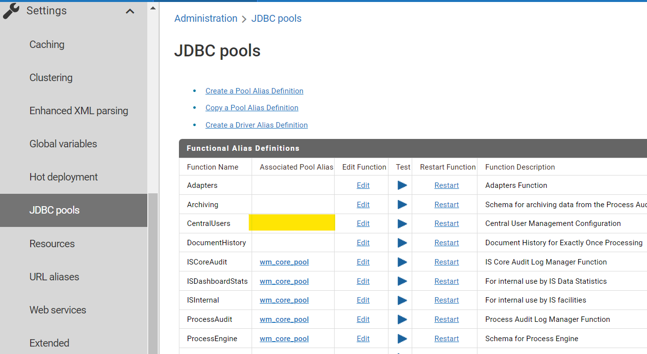

    Recommended way to configure directory services is to configure it on MWS and use central users DB connection to get that configuration to IS. If you haven’t followed these steps, follow those steps one by one. After that if that doesn’t fix your problem, please share a screenshot of your IS JDBC pools and MWS central users configuration. You can use MWS administrator UI to query directory services to validate your connection to Directory services. You should also be able to configure it through Command Central if my memory is correct.
    If you are not using MWS to configure your IS directory services, send screenshot of your IS directory services configuration. I recommend using MWS to configure if you have that installed in your environment though.
    Central Users/JDBC pools, this needs to have the same database connection string with MWS db, if using MWS to configure LDAP. Mine is empty here.

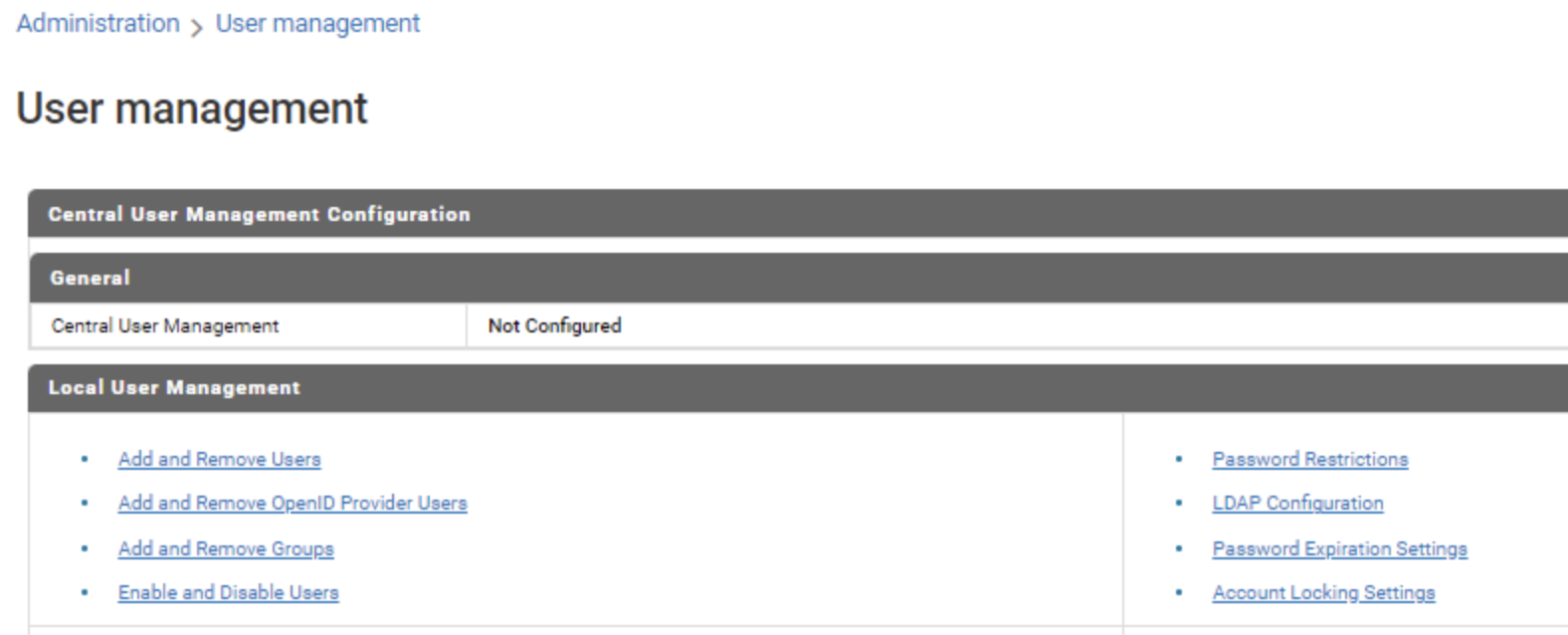

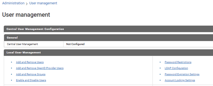

    With help of above, i configured CDS on my Integration Server.
    Central Users are Pointed to MWS DB.
    But i see Central User Management is Not Configured on Integration Server.
    Could you help me how to configure it ?

    i did that Resource settings pointed to MWS.
    But as mentioned in above , the Central User configuration is Not configured at User Management.
    Please help me here.
    Thanks !!

    1. Make sure to select Common Directory Services Support and Central User Management in product installation.
    2. On IS, Central User Management should be set to ‘configured’ [under Security>UserManagement>Central User Management]. if not configured,
        Steps to enable. Point Central users (under JDBC pools) to MWS_DB user (This user points to my MWS DB).
    3. After MWS is migrated to 10.15, make sure to update DB scripts (either via stacks or thru DCC) and CDS scripts are executed (CDS 10.11 CommonDirectoryServices WEBMDATA,WEBMINDX).
      If MWS is not used, we might need a seperate DB user to have this CDS config installed on DB.
    4. Restart IS if any of these above steps are performed.
    This has enabled CDS for me on IS and the initialization error is gone and CDS is working well.
