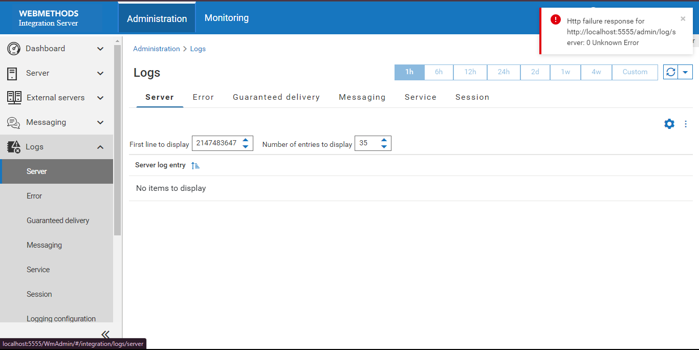

  • 1.  Cant open webMethods IS server log and error log
    Posted Tue July 30, 2024 09:12 AM
    Product/components used and version/fix level:
    web method integration server console version 10.15
    Detailed explanation of the problem:
    it show error when click server and error
    Error messages / full error message screenshot / log file:
    Question related to a free trial, or to a production (customer) instance?
    #webMethods
    #Integration-Server-and-ESB
  • 2.  RE: Cant open webMethods IS server log and error log
    Posted Tue July 30, 2024 09:52 AM
    Hi Lukisan,
    is there anything related to this when viewing the server.log file manually on disk or via the older WmRoot admin pages instead of using the newer WmAdmin admin pages?
    Regards,
    Holger
    #webMethods
  • 3.  RE: Cant open webMethods IS server log and error log
    Posted Tue July 30, 2024 12:17 PM
    Hi Holger,
    yes the on disk server.log file and WmRoot work just fine thank you.
    any idea to make it works in the newer WmAdmin admin pages other than reinstalling?
    Regarsd,
    Lukisan
    #webMethods
  • 4.  RE: Cant open webMethods IS server log and error log
    Posted Tue July 30, 2024 12:48 PM
    Hi Lukisan,
    unfortunately, I have never worked that deep with such a version as we had to retire our project for other reasons before we could upgrade to such a version.
    But you might want to check the IS Administrators Guide for further informations.
    Eventually you have missed some configurations somewhere which make the invocation behind the succes fail.
    “Unkonwn error” is quite unspecific error message, therefore I hoped that looking up the logs via other ways might reveal a bit more specific error message here.
    Regards,
    Holger
    #webMethods
  • 5.  RE: Cant open webMethods IS server log and error log
    Posted Tue July 30, 2024 02:52 PM
    I had that same error when we upgraded. Turns out the browser extension uBlock Origin’s filtering rules blocks the IS logs HTTP requests. If you have any ad blockers, try turning them off for the site.
    #webMethods
  • 6.  RE: Cant open webMethods IS server log and error log
    Posted Tue July 30, 2024 10:57 PM
    yes this solve my problem, thank you dave
    #webMethods
