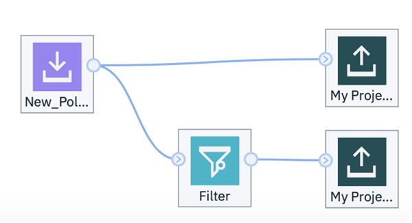

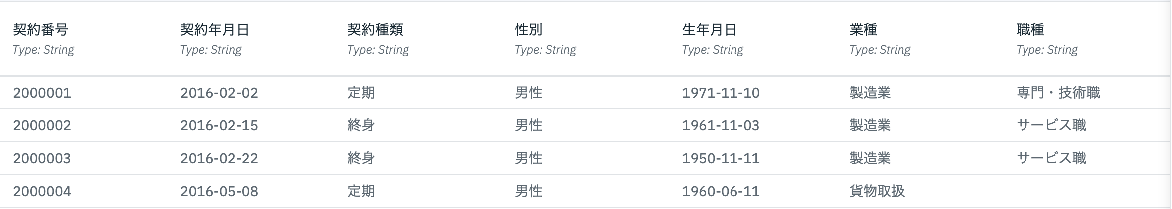

    I tried to export data containing YYYY-MM-DD field like following in Modeler flow.
    But I got following message.
    It seems that it relates to Date fields, so I omitted two YYYY-MM-DD fields from original data with Filter node. Then I could successfully export data. (The flow upper side in the following image got the error and the flow lower side could successfully export data.)
    Test flow I created when export error occurred
    How should I do to export YYYY-MM-DD data?
