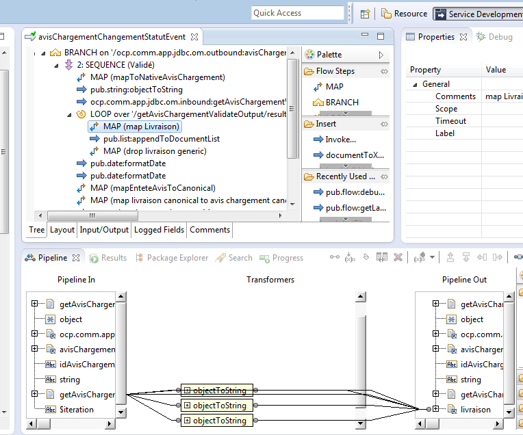

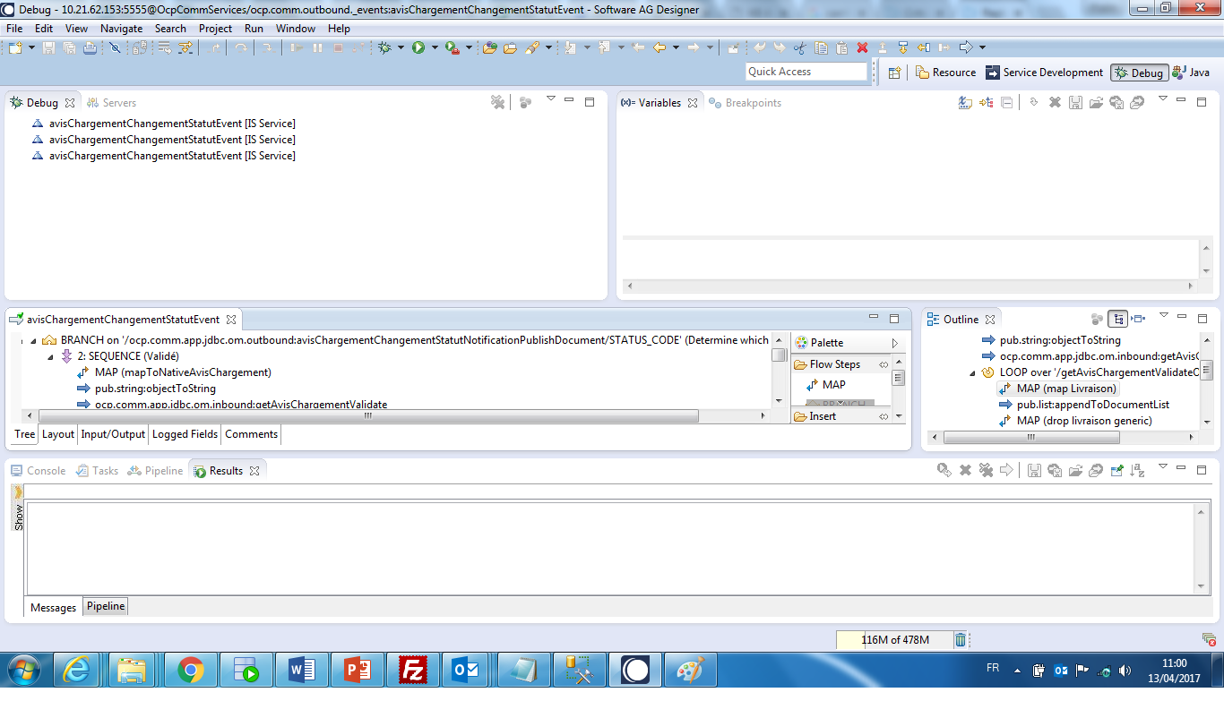

  • 5.  RE: can't debug flow service on designer
    Posted Thu April 13, 2017 08:04 AM
    Hi Holger,
    Thank you for your reply,
    Please find attached a screenshot of my service with map that contains transformers, also the perspective debug mode.
    Yes if i don’t fine any solution and the problem still persiste i will open a support incident on Empower eService.
    Regards,
    Nezha
