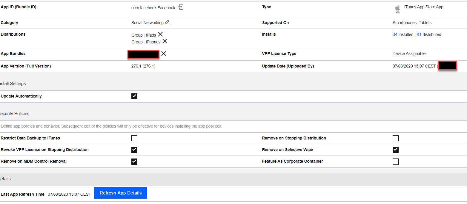

    Hi we have installed Facebook app from VPP on superviced devices (iPads), the app installs itself and everything looks ok, when we try to open it, it closes immediately again.
    The app is not blacklisted in policy and VPP licenses are ok.
    I can not figure out what is causing this, hope someone can assist.
