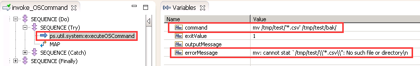

  • 10.  RE: cannot execute command with executeOSCommand service.
    Posted Tue January 06, 2015 11:13 PM
    Hi MR,
    command: mv /tmp/test/‘*.csv’ /tmp/test/bak/
    the actual filename is abc.csv
    The result as following attachment:
    errorMessage: mv: cannot stat `/tmp/test/'*.csv'': No such file or directory.
    #webMethods
    #Integration-Server-and-ESB
    #Flow-and-Java-services
