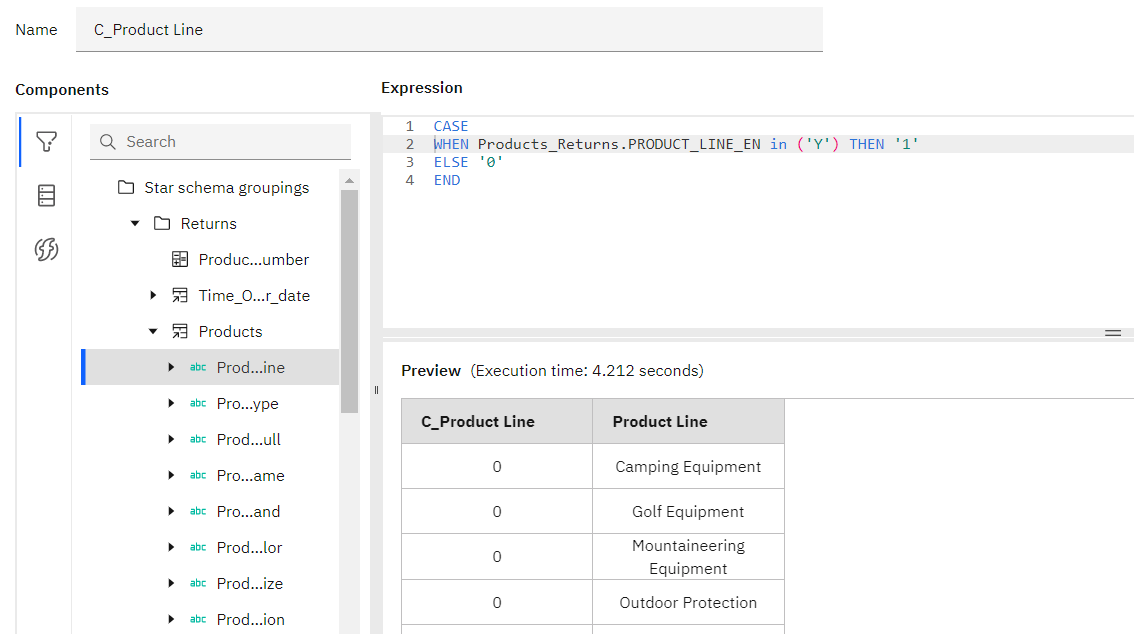

    I have some columns with Yes/No data and am trying to convert them to 1/0 so I can preform calculations and counts. What formula in calculations will help me perform this swap?
    I don't know what calculation formula to use, but I found this one online:
    CASE
    WHEN [DATASET] in ('Y') THEN '1'
    ELSE '0'
    END
    I get the error message: The expression is not valid. I also tried sorting the DATASET by group, to group Yes to 1 and group No to 0, but then that messed up the visualizations in my dashboard.
    What is the best way to go about this?

    Hi Kristen,
    Here is a working example:
    case [Country]
    when 'Canada' then (1)
    when 'United States' then (1)
    else (0)
    end

    Kristen,
    Another idea, you might want to check for Y, N and maybe Unknown answer (or whatever). So the logical expression would be:
    case [Answer]
    when 'Y' then (1)
    when 'N' then (0)
    else (null)
    end

    That syntax should be OK.  Patrick's suggestions should be OK to and, in the case of the latter, have the advance of handling all possible states.
    Usually there *should* be more text to the error.  Was there anything else in the error message?

    Your '1' and '0' will be treated as strings/characters. If you want to use these as measures, for example total up the number of Yes, then you want the number 1, not the string 1. Remove the quotes for a number.
    You can total up numbers, for example 1+1+0+1, but you cant total up strings, for example '1'+'cat'+'dog'+'0'.
    It may simply be that you were trying to use a string in a chart.
