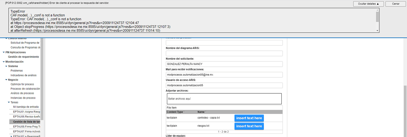

    I have a Async Command Button that execute a method on server that remove a FileItem from a FileItem ArrayList. This button is on a row in my table that I created from my FileItem ArrayList.
    When I click on these button “insert text here” with following configurations:
    show the following error:
    My java method is:
    The log is:
    And the remove item is succesfull. If I submit the form with submit button that refresh the form the image that I removed doesnt exist.
    So, why these error is showed? Im using google chrome.
    [POP.012.0002.wm_cafshared/hidden] Error de cliente al procesar la respuesta del servidor.
    TypeError
    CAF.model(…)._conf is not a function
    TypeError: CAF.model(…)._conf is not a function
    at https://procesosdesa.ine.mx:8585/ui/dyn/general.js?l=es&v=200911124737:12104:47
    at Object.stopProgress (https://procesosdesa.ine.mx:8585/ui/dyn/general.js?l=es&v=200911124737:12107:3)
    at afterRefresh (https://procesosdesa.ine.mx:8585/ui/dyn/general.js?l=es&v=200911124737:11014:10)
    at onComplete (https://procesosdesa.ine.mx:8585/ui/dyn/general.js?l=es&v=200911124737:11045:1)
    at klass. (https://procesosdesa.ine.mx:8585/ui/dyn/general.js?l=es&v=200911124737:1638:34)
    at klass.respondToReadyState (https://procesosdesa.ine.mx:8585/ui/dyn/general.js?l=es&v=200911124737:1512:52)
    at klass.onStateChange (https://procesosdesa.ine.mx:8585/ui/dyn/general.js?l=es&v=200911124737:1457:6)

    Hi, Firoz. Thank you for your reply.
    Actually no one javascript code is being execute. But I found this:
    This is the html code caf generated
    When I click on this button the console in chrome show this:
    The last line says that error is on click event, so:
    but this code is automatically generate by CAF with the following properties:
    And the Client-Side Events looks like:
    No click event is written

    Hi, Firoz.
    In the refresh button property I removed the table ang I set “_none” on it. Then I test the button action and the current error doesnt appear! Then I verify if the deleted file has gone and it is.
    If I can not refresh my table from the refresh button property, so what can I do for refreshing my table?
    Thank you very much!
