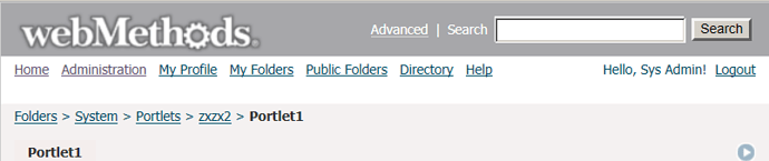

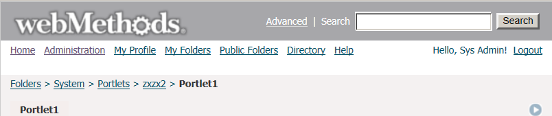

    I’m new to CAF portlet development. I’m using Designer 8.2 to create portlets. When I view my portlet in a web browser I see the following headers and footers (see attachments).
    How do I modify/change what the headers and footers look like?
    Can I create my own? If so how?
    I looked at the CAF Development Help documentation but did not find anything that describes how to do this. I thought maybe it could be done with MWS Adminstration but I’m not sure this is the correct approach or not.
    Any ideas on how to do this will be appreciated.
    Thanks.

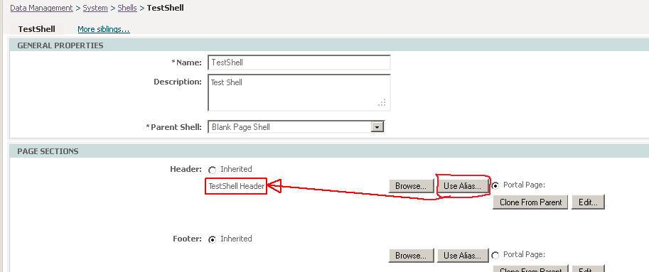

  • 7.  RE: CAF Portlet Headers and Footers
    Posted Wed April 30, 2014 02:01 AM
    Hi Gilbert,
    These are the steps for including the custom portlet in shell rule:
    • Create the custom header portlet (this you already created).
    • Create the alias for this custom header portlet via ‘Alias Management’
    • Create the new shell rule
    • Under page section of shell rule you will find Header which is by default be ‘Inherited’.
    • On the same section click on Use Alias button
    • Provide the alias of the custom header page you created under ‘Alias Management’ (in 2nd step)
    • Name of your custom header will appear below the radio button for Inherited.
    similarly you can set the custome footer as well.
    Please find the screenshot for your reference.
    Further you need to set the evaluation order of your shell rule to get it triggered for the desired user.
    Hope this will help :slight_smile:
