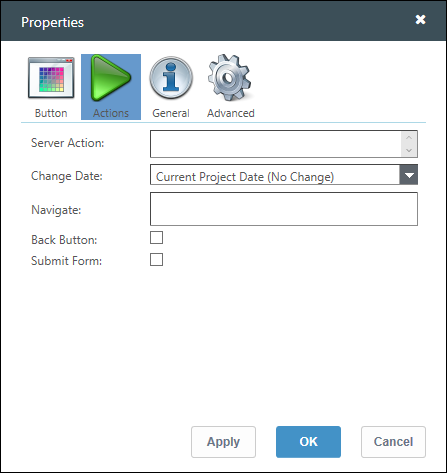

    Hi,
    Does anybody have experience using a button to navigate to an external report or site? Were you able to just copy and paste the URL into the Navigation field? Or did it require some extra coding?

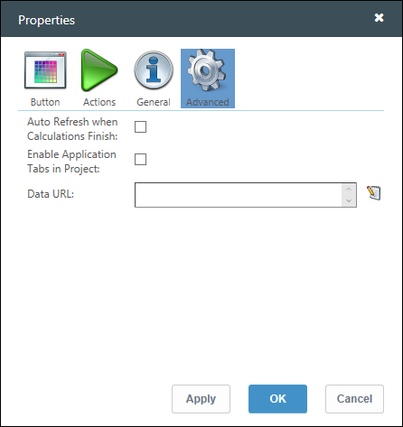

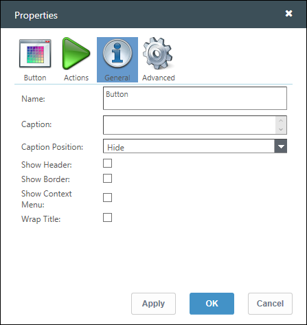

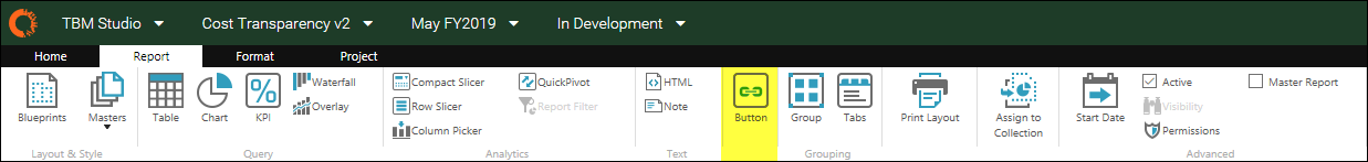

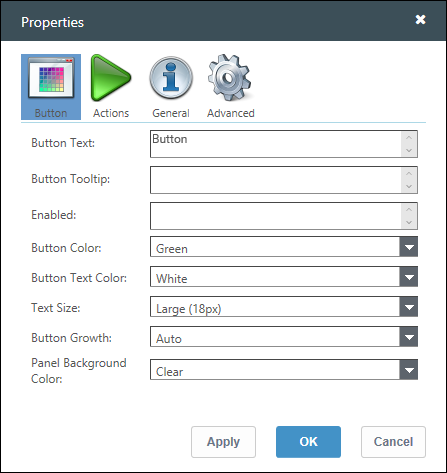

    Do you or anybody knows if we able to use the standard Button in Apptio in this case as well by updating the properties?
    Properties:
    #Platform

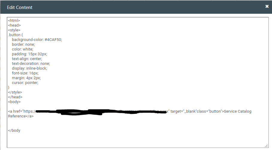

    We have a button with HTML for a link to our external service catalog reference.
    Below is the HTML for the above box
    @Menno Wittebol, We are not using the standard button for this, I'm not sure if we have done that before, might be something to test out in the sandbox/test environment
