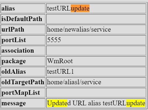

    @dekaa,
    There is updateAlias Service in WmRoot to update URL Alias as below.
    wm.server.httpUrlAlias:updateAlias
    But its good practices to update the URL Alias from the Admin UI. let me know what is your use-case here and your need is to update this in Production environment ?
