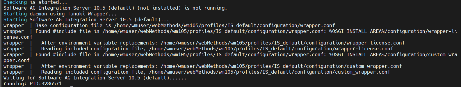

    Thank you, now Process Instances working fine. Now I am facing issue with IS(10.5). I am getting following scripts after starting IS.
    Please help to sort out this issue.

  • 5.  RE: BPM Instance
    Posted 02/20/22 12:39 PM
    Can you shed some more light on what is the issue here? Is it the case that Integration Server doesn’t complete starting up? Or perhaps it gets stuck with these lines only?
    Because from the logs it appears to be normal to me.

  • 6.  RE: BPM Instance
    Posted 02/21/22 07:35 AM
    Thanks for the response. Yes the server was getting stuck up after these lines. So what I did I shut down all the servers i.e. IS, UM, MWS, Analytic Engine,Infrastructure, and DataCollector. And Then restart all of them as in the following series: UM, IS, MWS, Analytic, DataCollector and Infrastructure. Then all starts successfully and now working fine.
