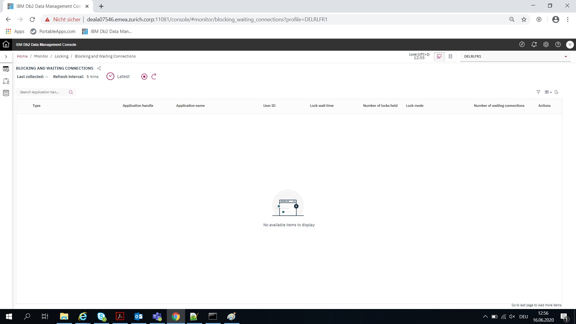

    we use the most current version of the console, i.e. 3.1.1.0, and discovered an issue with the "Blocking and Waiting Connections" view under "Locking".

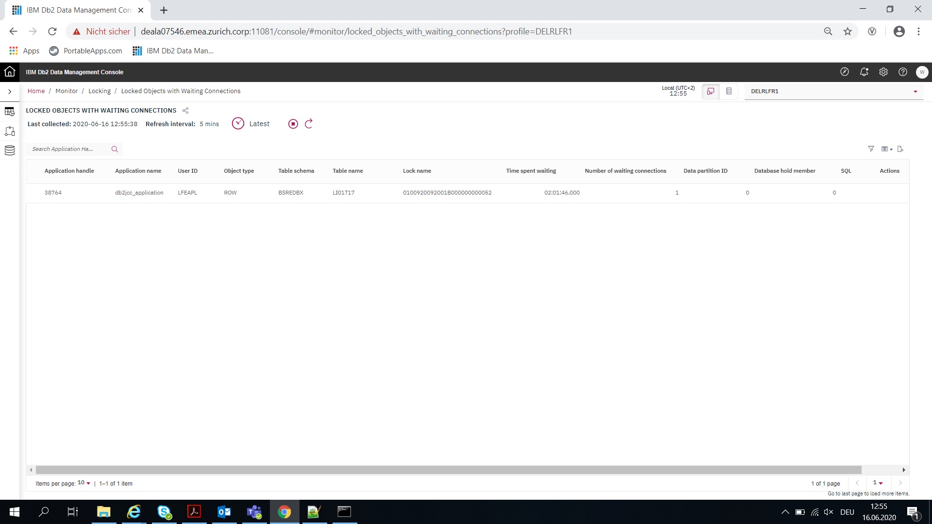

    Although we can see an entry under "Lockes Objects with Waiting Connections", no entry appears under "Blocking and Waiting Connections". But a query on view "MON_LOCKWAITS" reports these blocking/waiting connections. See the following screenshots. Is this a known issue?

    Yes, this is a known issue in DMC as the existing pruning logic is preventing to show all the blocker and waiter information captured in history in version 3.1.1.
    The issue is fixed in upcoming DMC 3.1.2 release.

    The known issue Jason mentioned is for historical view. But I notice that you're viewing the current records.
    Could you please view the 'Find locked objects' page and do show 'lock status' column(it's hidden as default)? The blocking and waiting records come from the source of 'Find locked objects' page in current design. If you can provide the screen shot of that page, we can check if those records can produce a blocking record.

    you are right, I talked about current records. Currently I cannot reproduce the issue, but I will do as you suggested when the issue occurs again.
