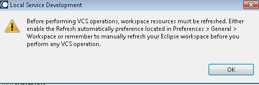

    Can you please provide further details on the reason why you have to do a package reload to get all the changes after startup of Designer? This step is required to solve what kind of issues?
    After further investigation, I decided to look into Subclipse plugin as well (for an initial comparison with Subversive from Polarion).
    Regardless of the plugin you use on top of Designer, you can configure an automatic refresh of your workspace that gets executed before you perform any VCS operatin (go to Preferences → General → Workspace for this). This will make sure that the workspace is synchronized with the underlying filesystem.
    There’s also a warning thrown by the ID itself when I try to commit my changes from the working copy. See the attached screenshot for details.
