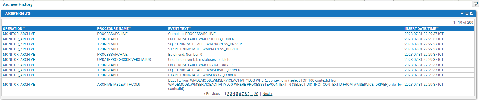

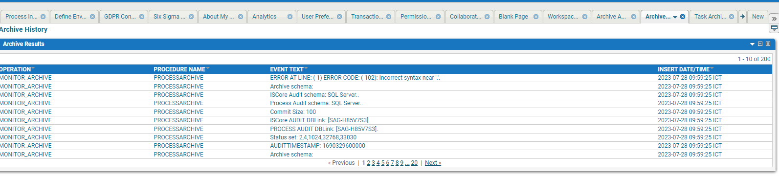

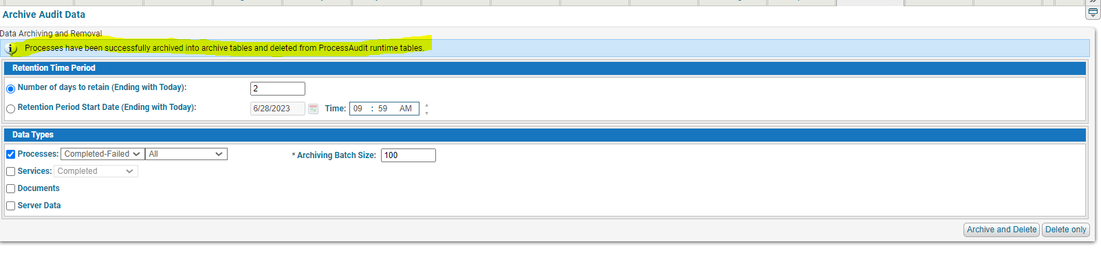

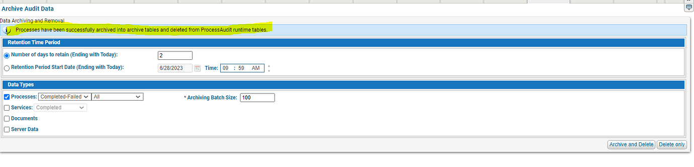

    I tried running archive audit data archive and deleted but the record of table are not truncated/deleted and also not archived even though Archive History return success such as “Processes have been successfully archived into archive tables and deleted from ProcessAudit runtime tables”
    below the archive history result

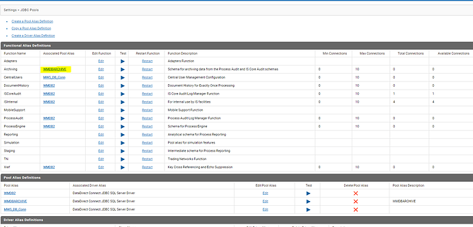

    and also I separate archive table and process audit table as shown below
    is there any config i missed, so archive audit data doesn’t work even though it returns success ?

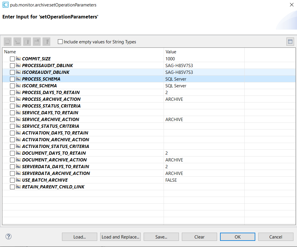

    i also already set the config in pub.monitor.archive:setOperationParameters, is this correct?

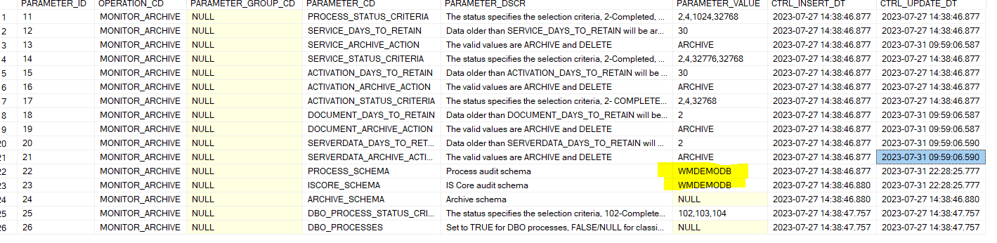

    in the Archive-Schema there is a table called “OPERATION_PARAMETERS” which hold the configurations shown above.
    The parameters PROCESS_SCHEMA and ISCORE_SCHEMA need to point to the live schema where IS and/or PRT are storing their audit data. I doubt that “SQL Server” will be the right value for that.
    I assume that SAG-H8SV753 is the name of your SQL-Server instance instead of the schema name, is this right?
    If not, the value SAG-H8SV753 might be uses as the Schema name then.

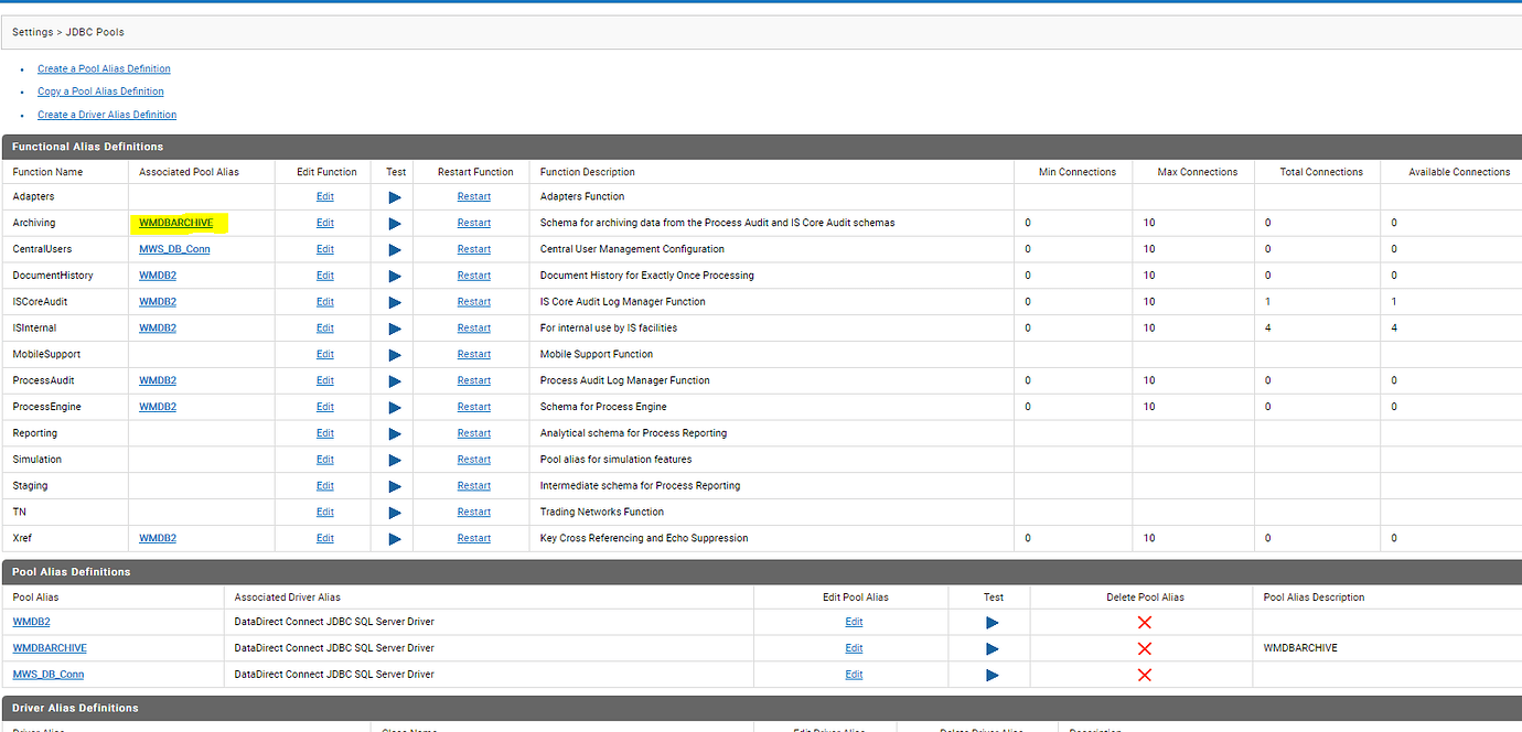

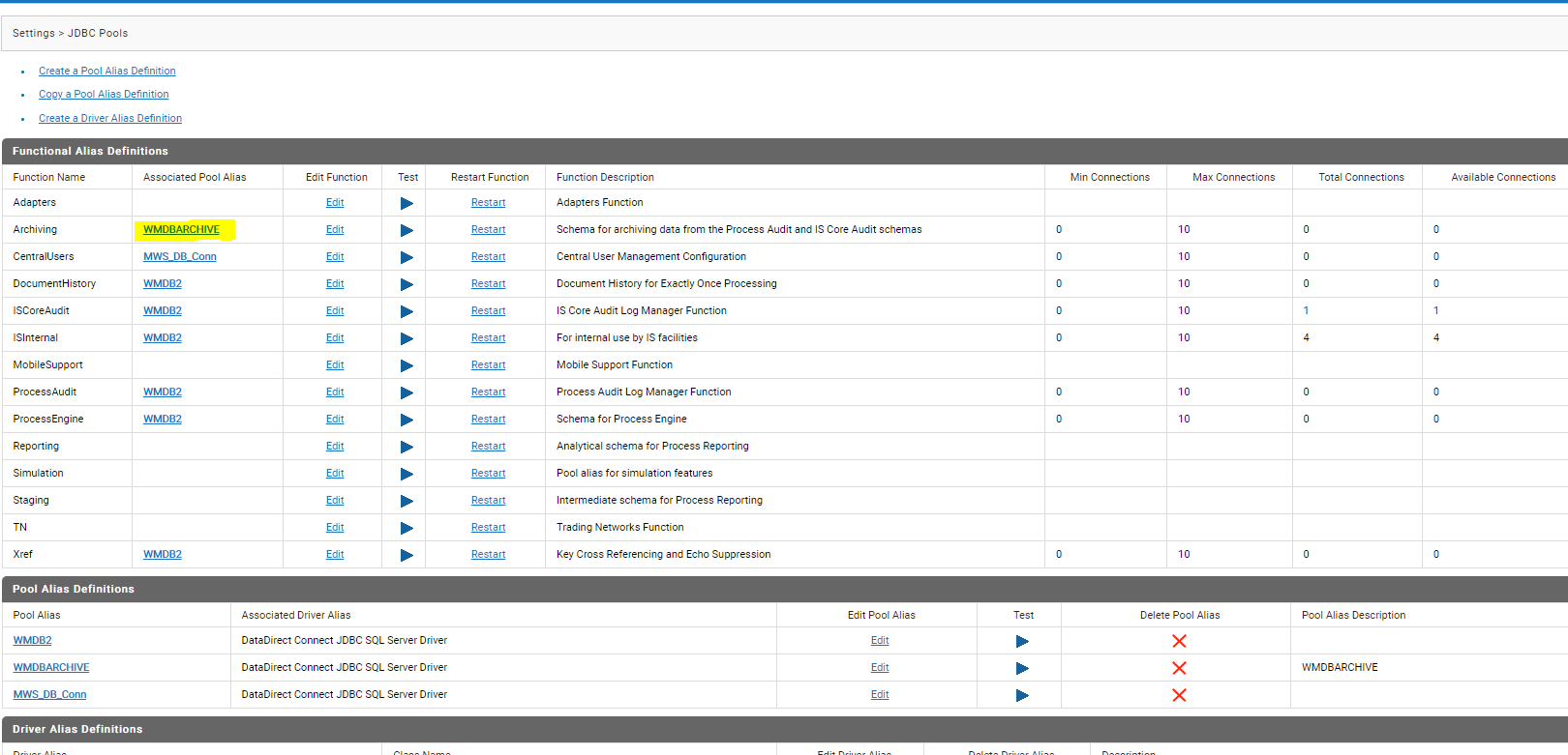

    To verify this I would like to ask you to share the pool alias definitions for IS Pool and Archive Pool from IS Admin.

    I’ve changed the parameters PROCESS_SCHEMA and ISCORE_SCHEMA with database name are currently used to store the audit data and to changes those parameters i’m use services pub.monitor.archive:setOperationParameters. and then it works!
    Table OPERATION_PARAMETER
    Audit History
