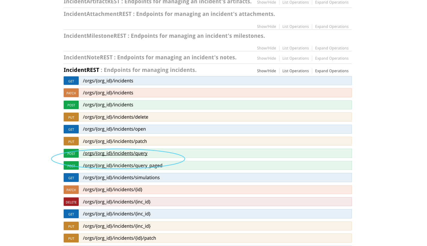

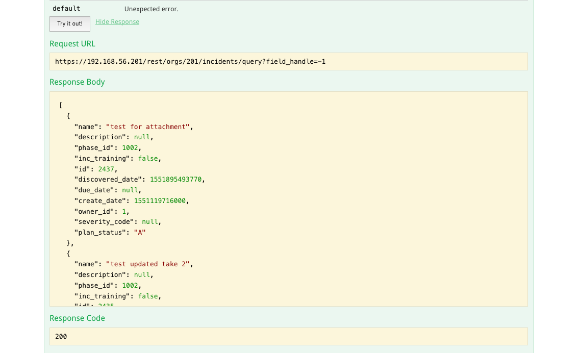

    One easy way is to use our Interactive API (Help/Contact->Interactive REST API).
    Then go down and click IncidentREST.
    Click the query link:
    The URL is shown there. You can try the REST API directly here.
