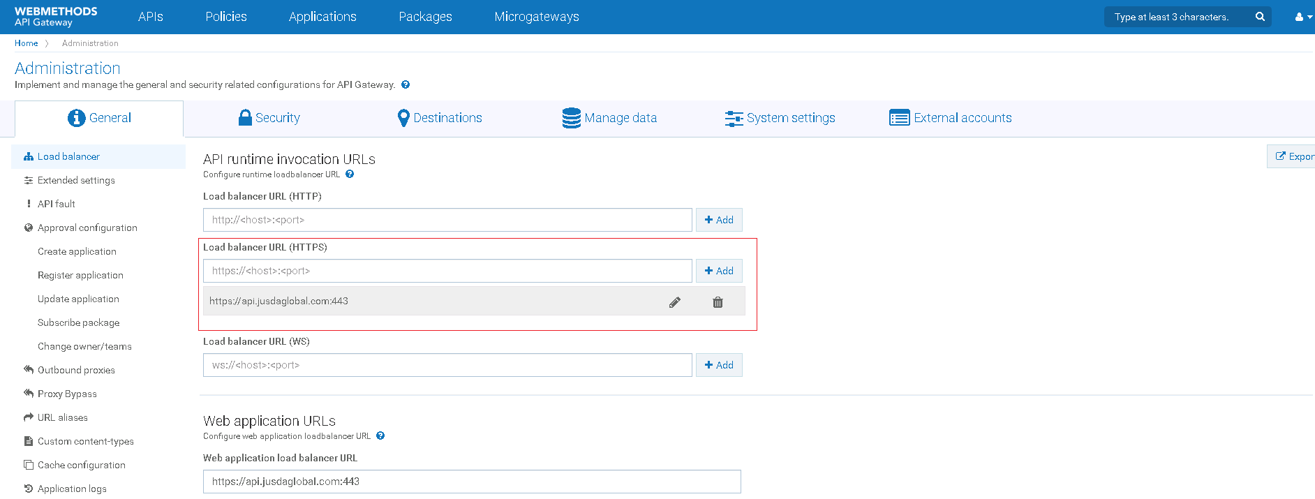

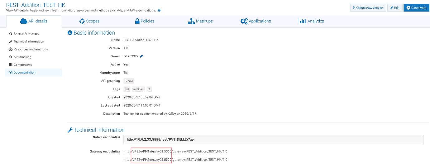

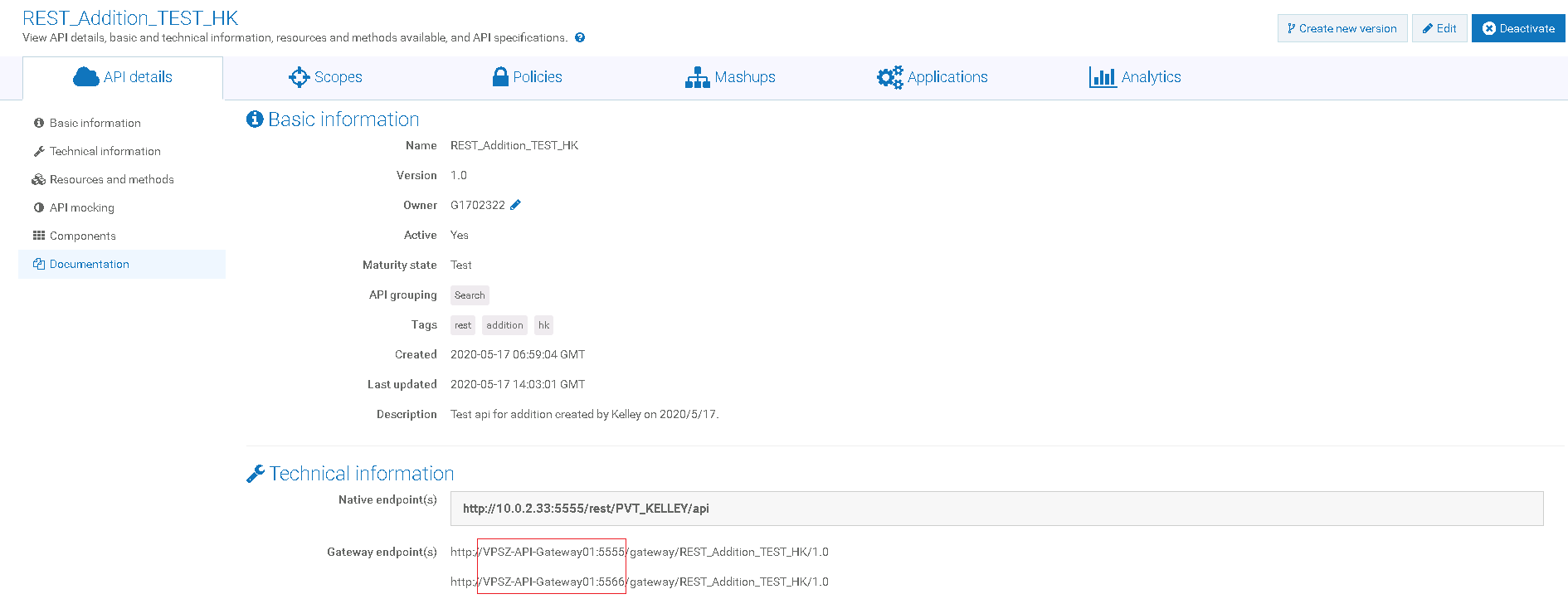

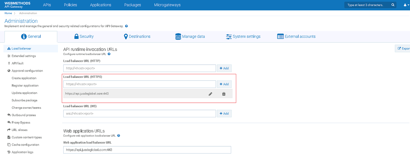

    We have configed an API Gateway cluster with 2 nodes, one intranet hostname of one node is VPSZ-API-Gateway01 and another hostname is VPSZ-API-Gateway02, and we use load balancer Nginx for the API Gateway cluster, the external URL for the nginx will be https://api.jusdaglobal.com:443/gateway, on API Gateway Administration load balancer configuration, we have configed an HTTPS url : “https://api.jusdaglobal.com:443” to match the URL of nginx, but after creating a new API, the Gateway endpoint is still intranet host name “http://VPSZ-API-Gateway01:5555/…” instead of nginx url “https://api.jusdaglobal.com:443”, we hope that the url exposed by the API in the Gateway endpoint is consistent with the url of nginx, what should we do.
    The screenshots of the API and Gateway Administration load balancer configuration are attached for your reference, thanks.

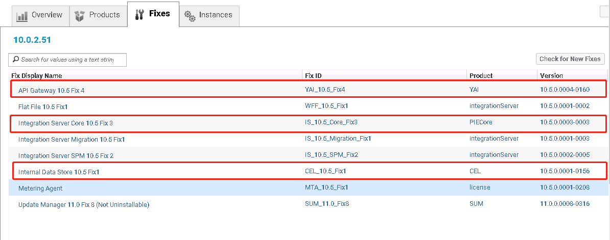

    Hi, Praveen:
    The API Gateway version is 10.5, and we have installed fix YAI_10.5_Fix4, IS_10.5_Core_Fix3,and CEL_10.5_Fix1 as attached.

    Hi Kelly,
    You have added LB for https and you didn’t select HTTPS in Policy → Transport → Enable HTTP / HTTPS.
    Option 1: Add LB for HTTP protocol
    Option 2: Enable HTTPS protocol in Policy → Transport → Enable HTTP / HTTPS
    #API-Gateway
    #API-Management
    #webMethods
  • 8.  RE: API Gateway Load Balancer Config
    Posted Tue May 19, 2020 05:43 AM
    Hi, Mohammed:
    When we enabled HTTPS protocol in policy, this problem was solved,thank you very much.
