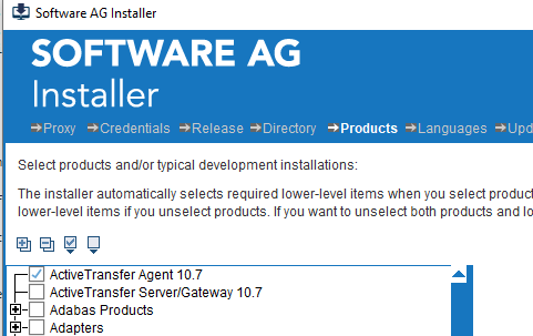

    Hi All,
    I am checking some ways on how file transfer is being done from active transfer gateway (DMZ) to active transfer server.
    I recently find this helpful. Link: File Transfer from Active Transfer Server to Agent through Active Transfer Gateway
    As I follow, I got stuck on this step and can’t find \MAG folder. Does anyone know why I can’t find this folder \MAG\configuration\com.softwareag.platform.config.propsloader
    I can see from <install_dir>\profiles but not the \MAG folder.
    Do I need some prerequisites to have this folder available?
    Thank you

    Hi,
    Please make sure that you have installed Active transfer agent then MAG folder will be available .
    Thanks
    Harsha
