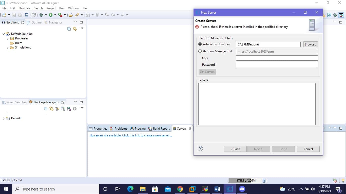

  • 3.  RE: Adding MWS remote server to runtime Environment in Designer
    Posted Thu August 19, 2021 07:35 AM
    Thanks for reply Holger
    I have tried with new option. FYI my servers are on Virtual Machine and my designer on windows.
    i have attached the screenshot.

  • 4.  RE: Adding MWS remote server to runtime Environment in Designer
    Posted Thu August 19, 2021 07:39 AM
    The “Installation directory” option is only when you have SPM and MWS on your machine (i.e., installed on the same machine as your Designer).
    If your Platform Manager (SPM) and MWS are installed on a local/remote VM, you will have to access them via the URL option. You will have to consider firewalls and open up ports on the VM.

  • 5.  RE: Adding MWS remote server to runtime Environment in Designer
    Posted Thu August 19, 2021 07:48 AM
    it is giving below error with below credentials
    “The currently selected server type does not support remote hosts”
    I’m using
    https://myServerIP:8585
    username : Administrator
    pass : manage
    firewall is also blocked

  • 9.  RE: Adding MWS remote server to runtime Environment in Designer
    Posted Thu August 26, 2021 06:29 AM
    Have you installed this plugin on your Designer?
    Designer > Composite Applications > My webMethods Server Support plugin
    Open up the SPM ports 8092 (no SSL) and 8093 (SSL) on the remote VM.
    P.S - I’m unsure if a remote server is in fact available as a feature; create a support ticket if the above options don’t work.

  • 11.  RE: Adding MWS remote server to runtime Environment in Designer
    Posted Sun August 29, 2021 01:04 AM
    Some components were missing and after installing them, I was able to see mws server in server list.

  • 13.  RE: Adding MWS remote server to runtime Environment in Designer
    Posted Mon August 30, 2021 02:22 AM
    Hi KM…
    Initially had a customized image in which below components were missing in designer
    Event Development
    SOA Governance
    Hope this will we helpful

  • 14.  RE: Adding MWS remote server to runtime Environment in Designer
    Posted Mon August 30, 2021 05:16 AM
    Hi,
    according to this list the most relevant component should be “Composite Applications (Framework)” here.
