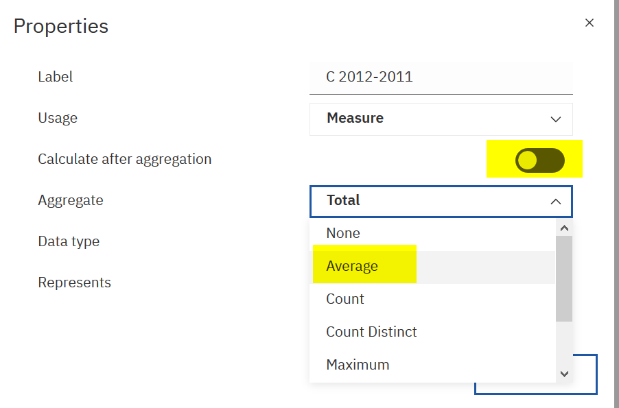

    Regarding average: you can also adjust the aggregation rule of your calculation when you uncheck the "Calculate after aggregation" property:
    Depending on what average you exactly want to compute this might be an option.
