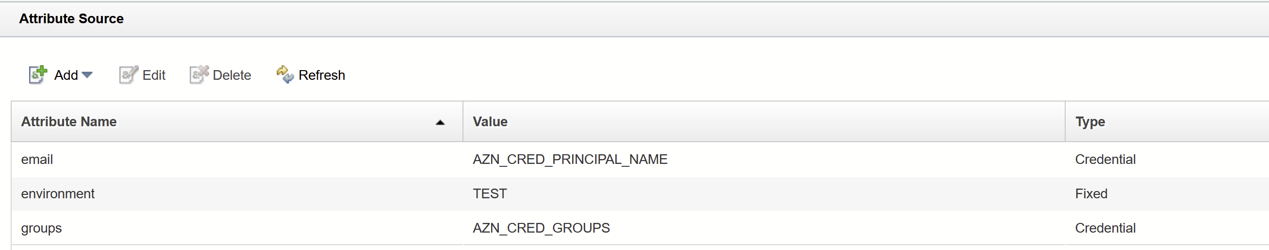

    What I did so far, was to create an Attribute Source, chose several, including a "fixed" attribute named "environment" with the value "TEST".
    Here is the configuration:

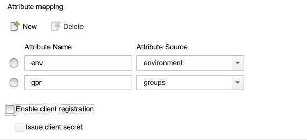

    After this, I went to OpenID Provider configuration and added some attributes:
    Hoping that now, these properties would show up in the JWT, which did not.
    Now I have a some questions:
    • What did I do wrong? why are the attributes not showing anywhere?
    • How do I specify whether the attributes should show in JWT or in the HTTP headers?
    • After adding in the OpenID Provider these attributes, what happened behind the scenes? I went to the Pre and Post scripts, and apparently nothing was changed there!

    Adding attribute sources/attribute mapping to an OIDC definition doesn't tell the system to always send those attributes.  It simply makes them available (using the "atttribute name") to be requested by the client.  The client requests specific attributes using a claim request (as mentioned in other thread).
    If you want the OIDC Provider to always provide an attribute you will need to edit the pre-token mapping rule to add it to the context.  There's information on the attribute type to set in the presentation I pointed to in the other thread.  If you wanted to you could also add logic to include the attribute based on received scopes.
