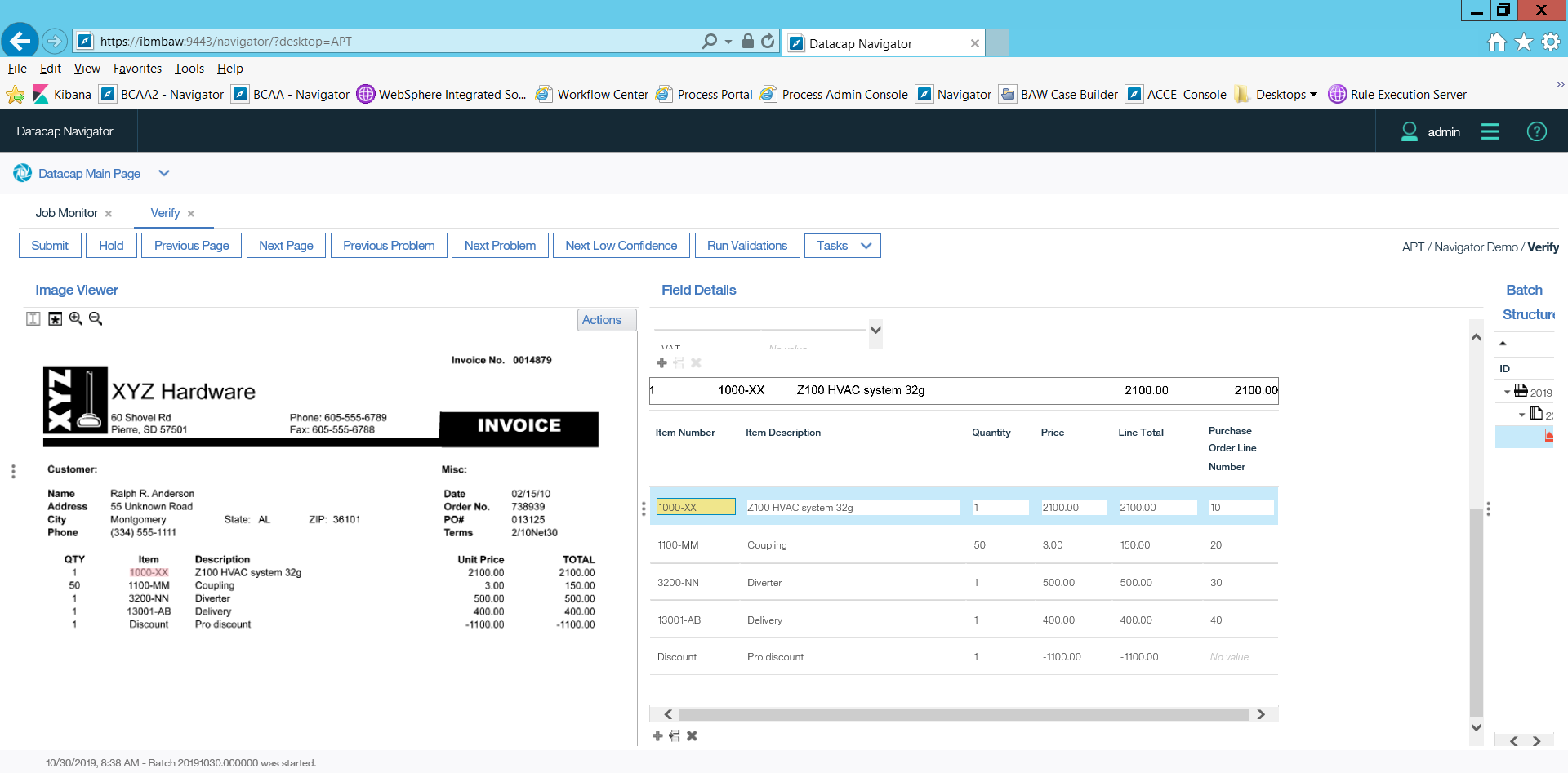

    I'm not sure what, either turning on +/->/x buttons or having these buttons or both, specifically is not allowed "by default" to you, because these buttons are there and enabled "by default" in APT application - see the screenshot below:

    Posted 10/30/19 09:48 AM
      |   view attached
    Your table looks differently than ours.
    Where's the difference? What should we use to have table like you have?

    The difference(s) can be found/confirmed only by someone looking into your application, which almost certainly is not using the concepts of table/lineitems as defined/intended by Datacap, which is implemented in APT application.

    it is not a support problem. they are using APT to define these tables and you show them a standard table verify.js.
    Marcel must use the standard Datacap actions to create the layout.xml using OCR A  like Recognition and the CreateAll fields.
    Once the tables are recognized in the tm_x.layout.xml then the fileds will be created for this page image.
    Once this created they must extract from all page fields only the table they need developing a custom action.
    This out of the box Datacap ICN Plugin verify.js  table functionality is developed only for tables on a single page and with fix columns number.
    As I know they are using APT and tables for invoices on more pages. this means once they want to use this standard functionality they must change their application and their concept and use no APT.
