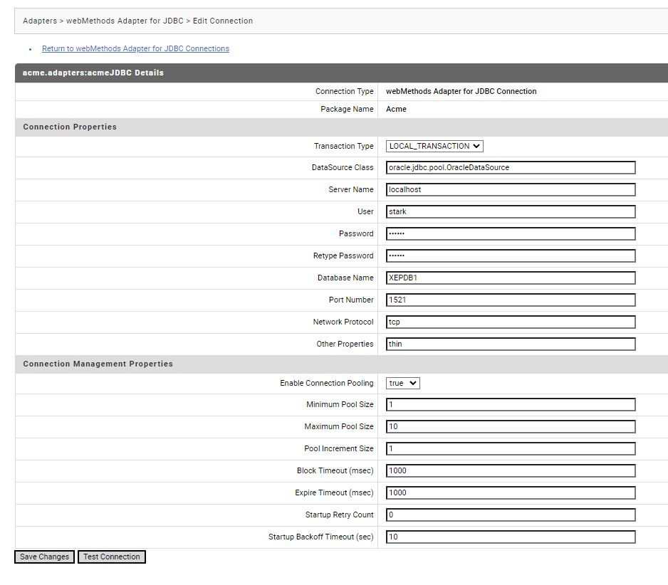

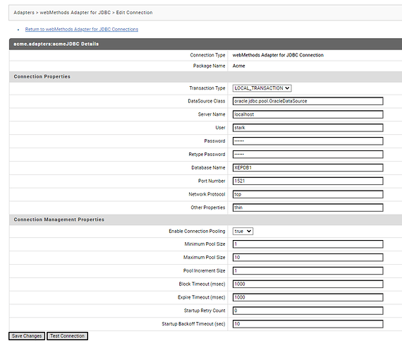

    I’m getting below error while trying to configure a JDBC Oracle connection.
    Any help is appreciated.
    Thanks.
    Error encountered
    [ART.118.5042] Adapter Runtime (Connection): Unable to enable connection resource acme.adapters:acmeJDBC.
    [ART.118.5036] Adapter Runtime (Connection): Unable to configure connection manager.
    [ADA.1.204] Cannot connect to the database with DataSource class “oracle.jdbc.pool.OracleDataSource”.
    Invalid Oracle URL specified: OracleDataSource.makeURL

    1 Other properties as: thin, oci and blank(upper and lower cases).
    2 Server name as : localhost, 127.0.0.1, 192.168.0.8(real local ip) and real machine hostname.

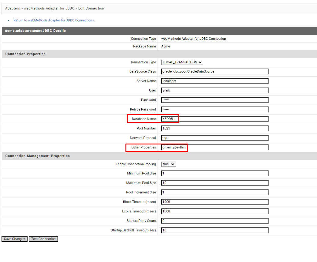

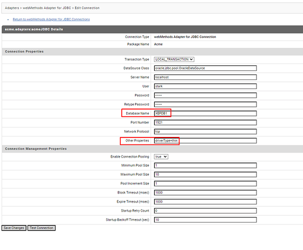

    Sorry for my misunderstanding. On second thought, it makes sense to indicate what type of property is being configured under “Other Properties”. After changing this to “driverType=thin” instead of just “thin”, the previous error stopped appearing, but unfortunately the new error below appeared.
    Error encountered
    Listener refused the connection with the following error:
    ORA-12505, TNS:listener does not currently know of SID given in connect descriptor
    (CONNECTION_ID=dJuSzI+WSRegC/VLURag2A==)
    This is how its set now:

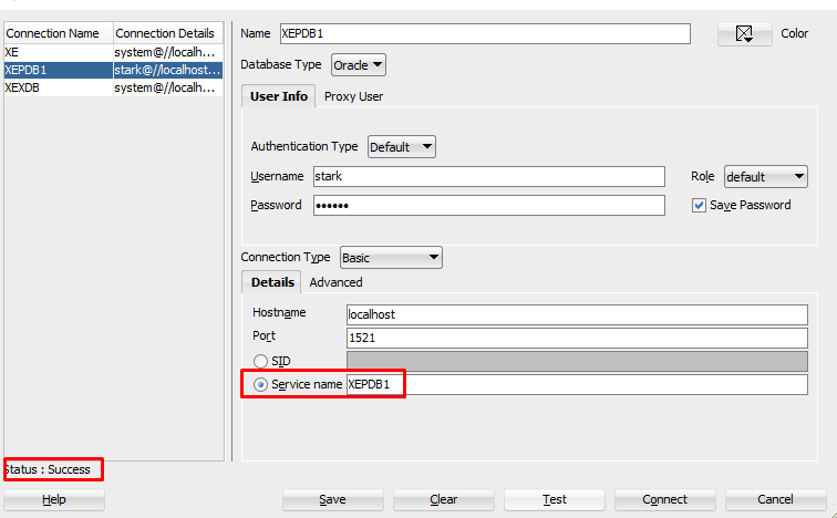

    This is how i connected to the same database using Oracle SQL Developer. Considering is configured with a “Service Name”, should the “Database Name” in JDBC Adapter Connection be set differently?

    can you check you Oracle installation for the files tnsnames.ora and listeners.ora?
    In one of these files you will have to configure a SID additionally to the service name.
    Or instead of specifying the databaseName, add a property to the other properties field with “;serviceName=XEPDB1”.
    Alternatively you can use the bundled DataDirect-Driver instead of the native Oracle-Driver.

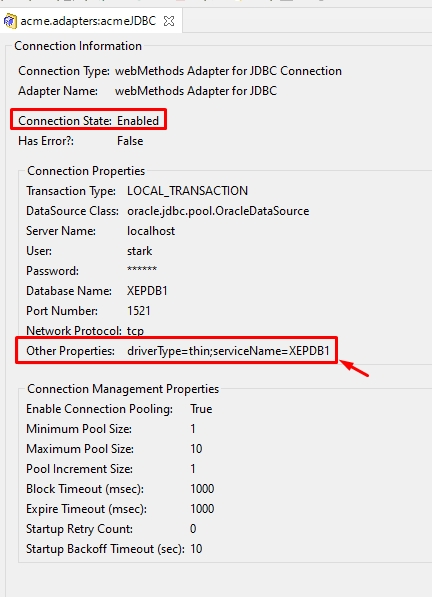

    setting “;serviceName=XEPDB1” did the trick.
    Thanks a lot man, i’ve been on this for over a day and running out of time to practice some coding.
    Now the fun begins… :smile:
    Thank you very much and have a good one!!!
