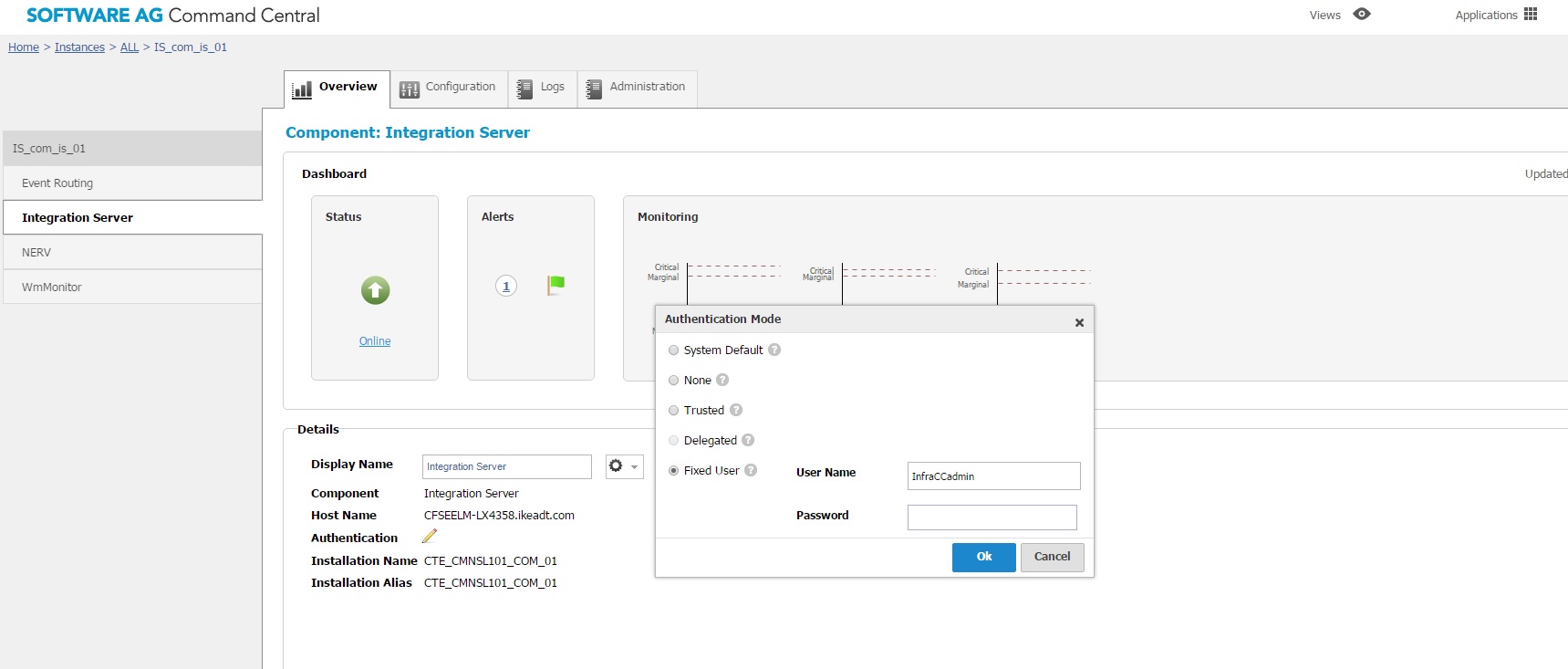

  • 5.  RE: Access Denied Errors For Admin User.
    Posted Mon August 08, 2016 04:35 AM
    Hi All,
    I was able to fix the error from GUI, by Providing a Custom User.
    Find the Attached Screenshot.
    Can some help me to provide CLI command to do the same ?

  • 6.  RE: Access Denied Errors For Admin User.
    Posted Thu August 11, 2016 05:06 AM
    Hi Sergei,
    Can you please provide your inputs on above query ?
    Regards
    #Command-Central
    #webMethods
    #webMethods-General
    #Integration-Server-and-ESB
  • 7.  RE: Access Denied Errors For Admin User.
    Posted Mon August 15, 2016 09:40 PM
    The command is what you used, but a bit simpler form and with the correct IS engine component id:
    export NODE_ALIAS=CTE_CMNSL101_COM_01
    export IS_INST_NAME=default
    cc add security credentials nodeAlias=$NODE_ALIAS runtimeComponentId=integrationServer-$IS_INST_NAME username=InfraCCadmin password=****
    Note that if you may address multiple nodes and multiple components ids with a single entry if you can glob them based on the node alias and/or component id pattern, e.g. to apply to any node which alias starts with CTE_CMNSL101:
    cc add security credentials nodeAlias=CTE_CMNSL101* runtimeComponentId=integrationServer-* username=InfraCCadmin password=****
    The above will only apply if there is NO explicit mapping to more specific nodeAlias and/or componentId.
    Thanks
    Sergei
    #webMethods-General
    #Command-Central
    #webMethods

  • 10.  RE: Access Denied Errors For Admin User.
    Posted Fri November 11, 2016 04:21 PM
    If IS version is 9.8+ the best option to set Authentication type to TRUSTED for both OSGI-IS_ and integrationServer- components. This is the default authentication type which avoids wrong passwords problems altogether.
    There is no benefit of using a separate InfraCCAdmin user vs Administrator user (which is used by TRUSTED auth) as SPM needs to have full admin access to IS in order to be able perform IS configuration and administration.
    If you still want to use basic authentication as InfraCCAdmin and experience issues configuring that, it would be best to open a support ticket and provide more information about your environment:
    • Versions of IS/SPM and CCE used
    • Fixes installed
    • Logs from IS and SPM
    • What steps have been done to setup InfraCCAdmin user and configure SPM to use it.
