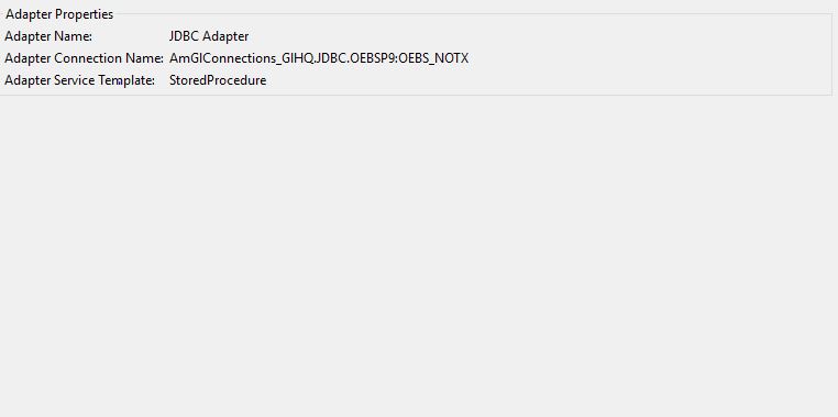

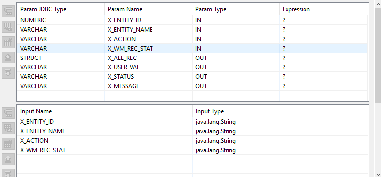

    We are having a output JDBC type as Struct. I have created a stored procedure when im running it is failing with below exception.
    The latest fix is JDBC_6.5_Fix50 fix. can you please suggest the fix available or any work around for a similar issue
    Launch started: 2015-11-19 13:15:53.831
    Configuration name: StoredProc_Main_Customer
    Configuration location: C:/Users/Krishna Gokaraju/workspace97/.metadata/.plugins/org.eclipse.debug.core/.launches/StoredProc_Main_Customer.launch
    Could not run ‘StoredProc_Main_Customer’
    com.wm.pkg.art.error.DetailedServiceException: [ART.117.4002] Adapter Runtime (Adapter Service): Unable to invoke adapter service Default.Krishna:StoredProc_Main_Customer.
    [ADA.1.316] Cannot execute the SQL statement "call XX_CI_PUB_ITO_074A_PKG.MAIN_CUSTOMER (?, ?, ?, ?, ?, ?, ?, ?) ". "
    (63000/3115) ORA-03115: unsupported network datatype or representation

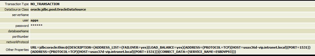

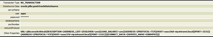

    Hi,
    can you share the configuration of the JDBC-Connection?

    I have checked with the DBA. They came back saying this procedure has been declared as table type so it cant be called directly in SQL developer instead they need to write a program to run the test.
    #Integration-Server-and-ESB
    #Adapters-and-E-Standards
    #webMethods
  • 23.  RE: 9.5 webMethods Select JDBC Adapter Issue with the TIMESTAMP
    Posted Mon November 30, 2015 02:00 PM
    OK can’t they alter the data type and make it available in your procedure to work ?
    HTH,
    RMG
