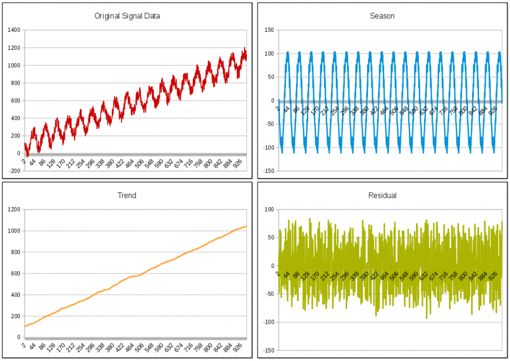

The above signal contains some very obvious characteristics. First, the data in the signal contains an oscillating pattern. In fact, this signal was created using a sine wave. This repeating cycle that you see in the signal is referred to as the season component. The second obvious characteristic is that the signal is continuously increasing. This is referred to as the trend component. Finally, there is obviously some randomness about the data. This randomness is referred to as the residual component.
By using this operator you can extract these three components into separate signals. The following image shows the result of decomposing the above signal using the STD2 operator.
STD2_Components
