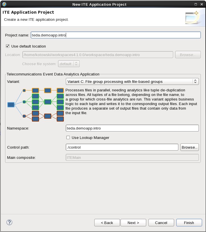

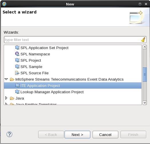

You setup the ITE application using the Streams Studio and the ITE Application Project wizard. For more details on how to configure Telecommunications Event Data Analytics for Streams Studio, please see the IBM Knowledge Center: Configuring Telecommunications Event Data Analytics for Streams Studio.
- Open Streams Studio.
- Select from the menu: File > New > Project… > InfoSphere Streams Telecommunications Event Data Analytics> ITE Application Project..
- Provide the teda.demoapp.intro project name and select variant C. The variants are discussed in more detail in the Knowledge Center.
By clicking Finish you create an ITE application that compiles and runs with embedded sample code. In Streams Studio, you see the new project in the Project Explorer view.
