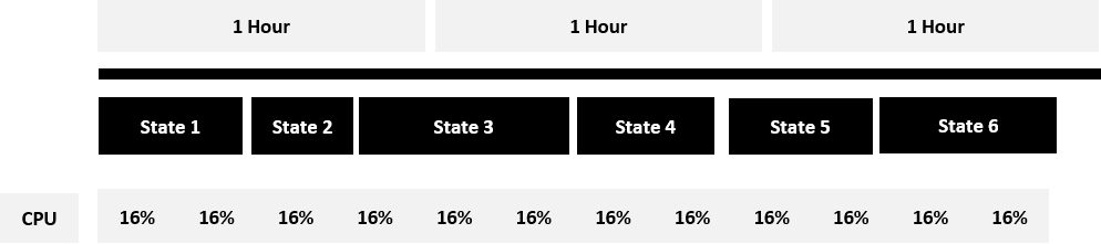

Approach 1: ExecuteProcess
Using a traditional ExecuteProcess, each state-based process runs sequentially as a single thread through a chore or a control process.
The diagram below shows what this looks like.  State file 1 is processed, then state file 2, etc.  Each file ticks along in the background and the whole thing would finish in just under 3 hours. Only 16% of the available CPU was used ( 1/ 6 core ).
There's nothing wrong with this approach, except that it just drags on.  It limits the amount of work that can be done in the overnight processing window.  It seems so wasteful to have five cores doing nothing for most of that time.

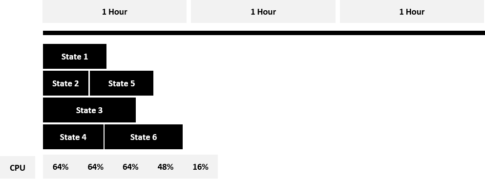

Approach 2: Hustle
When IBM introduced TM1RunTI back in 2018, the clever folks at Cubewise launched a small utility called Hustle that orchestrated the running of TM1RunTI.  It took a little bit of work to get running, but when set up correctly, Hustle would minimise the processing time by ensuring available the maximum numbe of cores were busy.  It could also leave headroom available to allow cores to remain open for users to continue working.  Best of all Hustle, would know when a process was finished, so dependent processes could be scheduled to run in the same job stream.
In this case, you'll see that our processing completed in around a third of the time. Hustle would start state file 1, 2, 3, and 4 together.  It then processed file 5 when core 2 became available, and file 6 when core 4 became available.  This was achieved without swamping the server.

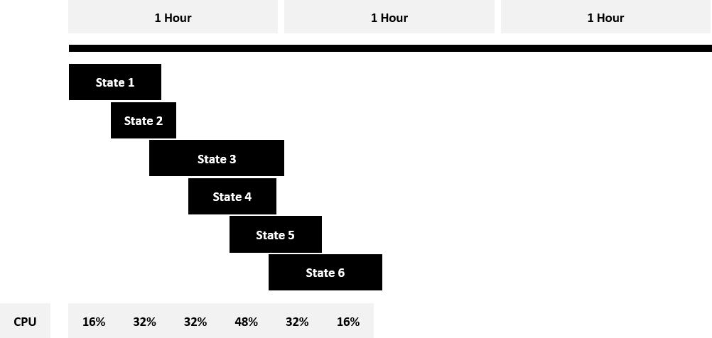

This is what a RunProcess looks like:
You can see here that state file 1 starts processing on its own.  After a predefined delay, state file 2 is then initiated.  After another delay, state file 3 is initiated.
Why?
Well although RunProcess does allow you to maximise the use of threads but it has two serious drawbacks.
The first drawback is that there is no easy way to know that the last process has finished.  Cubewise has proposed an approach using the synchronise function.  I have tested this and it does work, but it's still not quite as good as Hustle.
The second drawback is there's is no easy way to manage the server load. This can lead to the server becoming swamped and users not even being able to connect. The easiest way around this is through the use of a Sleep() command. When submitting a large number of RunProcess requests, I insert a wait period (say 20 minutes) to give the server a little time to recover.
If you have a large difference in the processing times, setting a long sleep time may leave large gaps between jobs.  If the sleep time is too short, the server may still become swamped as jobs bunch together towards the end.
This approach is not ideal, but it still gets the job done.
