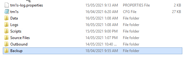

1.  Folder Structure
By logging into the remote desktop I created a folder called 'Backup' within our TM1 database folder. This is held at s:\prod\xxxx\ folder (where xxxx represents your database name, e.g. tm1).
Under the 'Backup' folder, I created two subfolders - "Daily" and "Monthly".
  • Under the Daily folder I have created 31 sub-folders.  These are named "01", "02".... "31", each representing a day of the month.
  • Under the Month folder I have created 12 sub-folders.  These are also named "01", "02".. "12", representing the month of the year.
I decided against creating a yearly folder, but I guess this logic could also be extended to do this if that was considered important.
This folder structure allows me to keep a daily backup for up to 31 days, and a monthly backup for up to 12 months.  By constantly overwriting old files, we can determine the maximum size of the folder as ( 31 + 12 ) x backup size.  This is important information to help you ensure that the server does not run out of storage space.

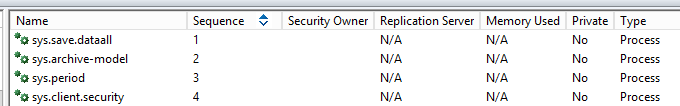

3. Overnight Chore
The backup process described above (sys.model-archive) is run as a part of the overnight chore.    As you can see below, this happens immediately following a complete database save.  Once that is done, we run the process above, before doing the rest of the overnight activities.
Once implemented, the technice is set-and-forget.  You do not need to worry that the folders will grow out of control, and the folder structure makes it very easy to locate the file you need.  I would also say that I have not had a single instance of the backup process causing the overnight process to hang, so I feel the Powershell method is inherently more stable.
