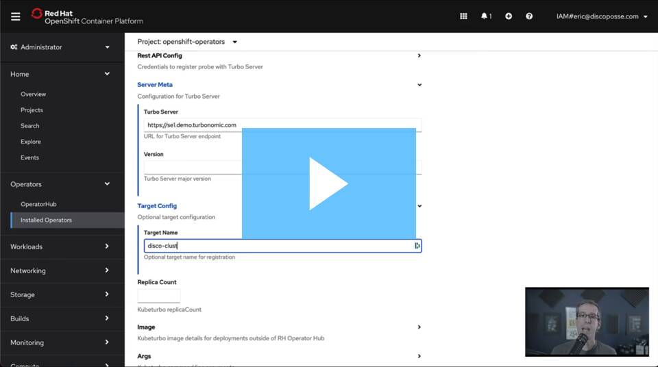

Logging into OpenShift and Configuring KubeTurbo
You are already up and running with OpenShift without any other configuration needs. Thank you, IBM and Red Hat on-demand goodness! Click down in the Operators section and you'll open up the search area for the OperatorHub to find the official Turbonomic operator.
The only options you have available should be fine as the default so that Turbonomic will have full visibility and access to all the existing (and future) namespaces.
Click the install button and the deployment should take just a couple of minutes. What's going on behind the scenes is a massive time saver because you're getting the latest code right from the OperatorHub so that you have no YAML to deal with, no Helm charts, no dials, no knobs, no worries. Operators make your administrative life nice and easy.
Next up is your configuration of the KubeTurbo to connect it up to your running Turbonomic ARM instance. All you will need is your username and password. An excellent configuration pattern is to create a specific service account on your Turbonomic instance for this environment in the case you have to roll over the credentials.
There are also options to use secret management which we can cover in a longer form blog in future.
Your URL for the Turbonomic ARM instance is needed. This will have to be available via the network to your KubeTurbo deployment. I've created a secure internet-facing endpoint behind a load balancer for mine for safety and ease of access from anywhere I need it.
The final setting you need is your cluster name. This can be a meaningful name using whatever naming convention you want to assign. If you don't specify a name then the default is Cluster_name which is what will show up in Turbonomic. This is why it's ideal to give it a meaningful name to make it quick to identify for your team.
Now we are submitted and ready for the next Turbonomic ARM discovery cycle to pull in all the analytics and dependency information from your real-time environment.
