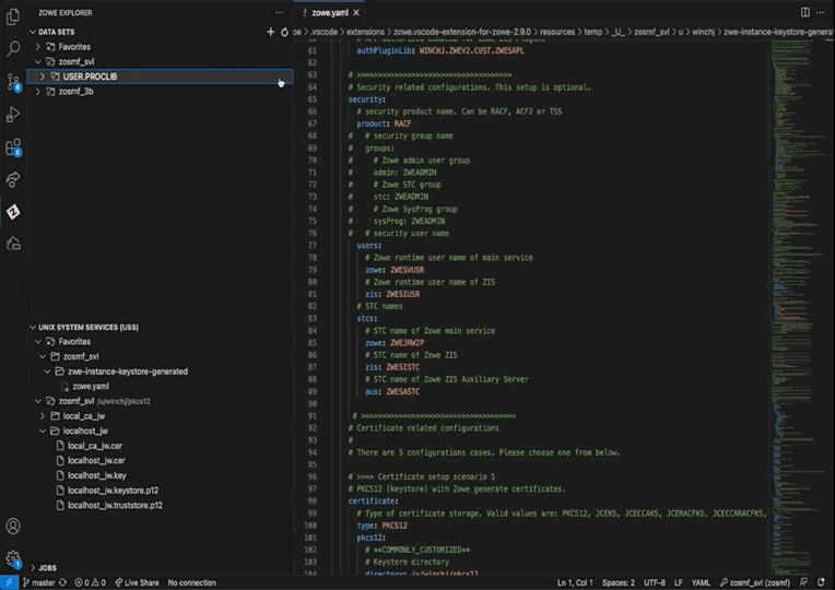

What we want to do is to create a new certificate to be used in Zowe. To do this, we can leverage Zowe’s helper utility through the zwe init certificate command. The input that the command (and other zwe commands) can execute is from the zowe.yaml file.
In this file, we specify everything to generate a new certificate in the zowe.setup.certificate section. To create a new PKCS12 file-based keystore (what we are trying to do in this blog), we need to configure the parameters in Certificate setup scenario 1, namely PKCS12 (keystore) with Zowe generate certificates.

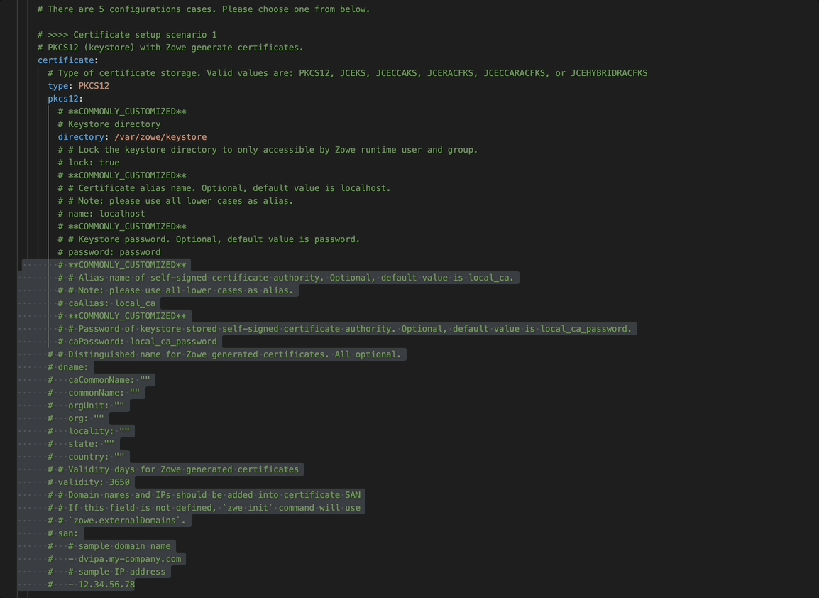

Now we can uncomment the scenario 1. By default, the example-zowe.yaml file template that you copied to create zowe.yaml will have the scenario 1 zowe.setup.certificateuncommented. We need to double-check and make sure the right section is uncommented.
*Notes: Be careful with lines 107, 111, 114 and 118 (see the screenshot below) starting with ** COMMONLY_CUSTOMIZED** as when uncommenting the whole block these may need to be re-commented back with the leading “#” character.
The section to be uncommented
Then we need to update the parameters in this section.
  • zowe.setup.certificate.type: to be PKCS12 to indicate this is a keystore certificate.
  • zowe.setup.certificate.pkcs12.directory: to be a directory to store the certificate artifacts within. For this blog, we’ve used /u/winchj/pkcs12 as an example. This directory does not need to exist and will be created as part of the zwe init certificate command.
  • zowe.setup.certificate.pkcs12.name: to be the certificate name, in our case, localhost_jw.
  • zowe.setup.certificate.pkcs12.password: to be the password used to protect access to the .p12 keystore.
  • zowe.setup.certificate.pkcs12.caAlias: to be the certificate signing authorities (CA) for the certificate, in this case, local_ca_jw.
  • zowe.setup.certificate.pkcs12.caPassword: to be the password of the keystore that stored self-signed certificate authority.
The following parameters are optional, and here are the values that we use in this blog.
zowe.setup.certificate.pkcs12.dname.caCommonName: to be"Zowe PKCS12 Cert" in this case.
zowe.setup.certificate.pkcs12.dname.orgUnit: to be "Zowe PKCS12 Org Unit.
zowe.setup.certificate.pkcs12.dname.locality: to be "Hursley".
zowe.setup.certificate.pkcs12.dname.state: to be "HA".
zowe.setup.certificate.pkcs12.dname.country: to be "England".
zowe.setup.certificate.pkcs12.san: to be the Subject Alternative Name which should include all of the domain names and IP numeric addresses that are secured by the certificate. This will be the hostname and IP address used by Zowe clients (web browsers or CLI profiles) to securely access the Zowe servers.
Configure the values in the Certificate setup scenario 1
*Notes: in the screenshots above, we are using the Zowe Explorer plugin for Visual Studio Code with coloring the content of zowe.yaml. So we can see comments in green, keywords in blue, values in brown, …. Be careful if you are using tools like ISPF or vi in OMVS or iShell to edit your zowe.yaml file, because it’s easy to make mistakes. For example, having an extra space, so the columns don’t line up correctly, or a line you think is runtime syntax is commented out or vice versa.
Now you are good to go to the next step with these values configured.

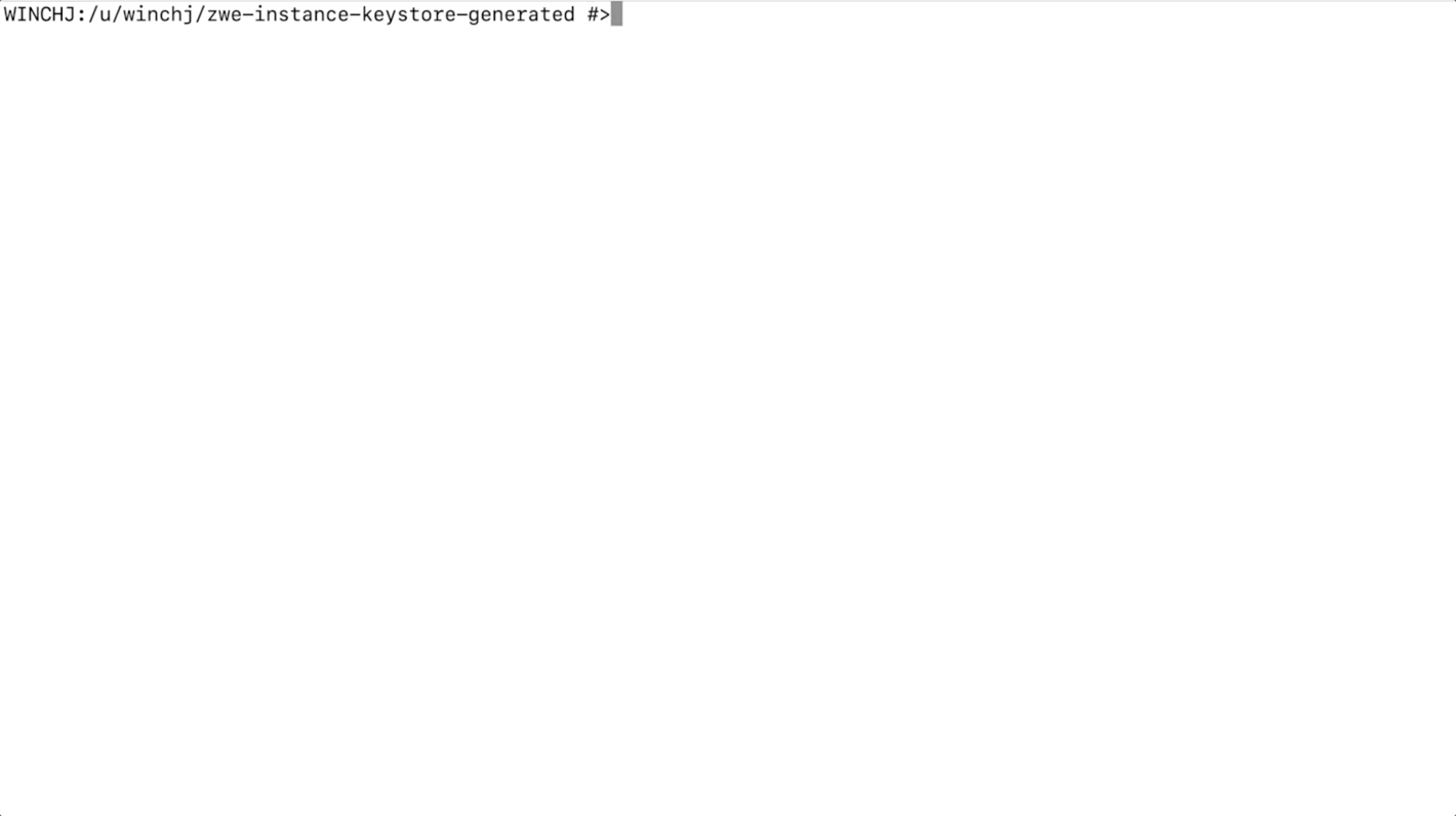

The screen recording shows the process when we are running zwe init certificate -c ./zowe.yaml. It will likely take a minute or so to complete because of the computation. So please be patient.
Run the `zwe init certificate` command

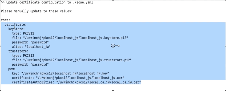

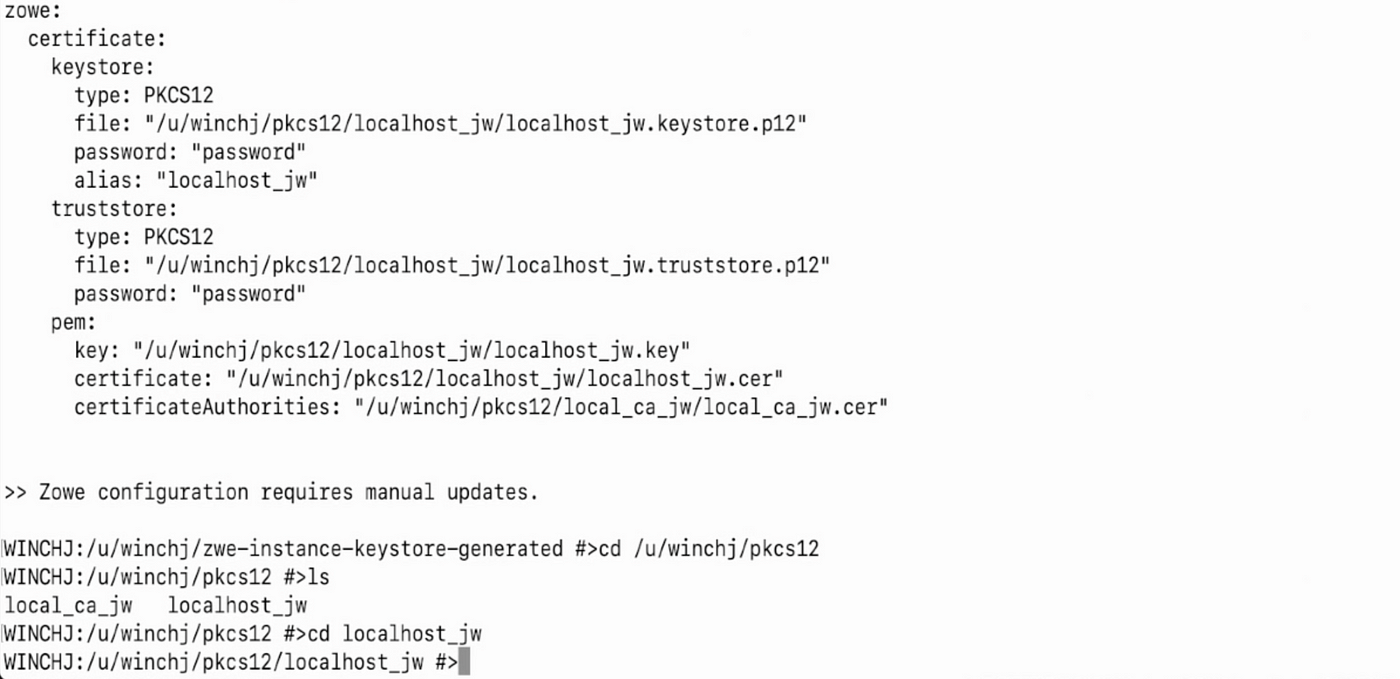

After running the command zwe init certificate, you will see that your certificate is successfully created and the values to be updated for thezowe.certificate section in zowe.yaml file.
Update the values in the `zowe.certificate` section

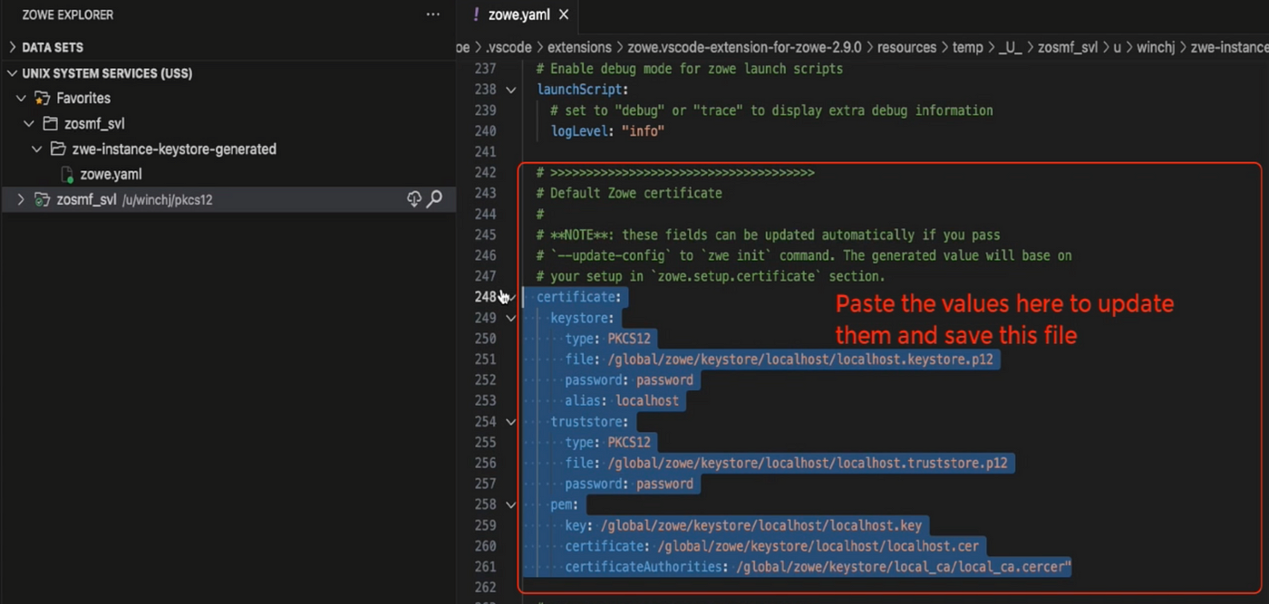

… and then you need to paste the values and pass them into zowe.yamlfile as shown below.
Update the syntax by pasting the values to the `zowe.certificate` section
If you are updating your zowe.yaml file for the first time you’ve copied it from the default template inexample-zowe.yaml, you’ll find there is already a zowe.certificate section. Overwrite this with the nice new syntax, telling Zowe that we want to generate a new PKCS12 file-based certificate.
  • zowe.certificate.keystore.type: to be PKCS12.
  • zowe.certificate.keystore.file: to be the path that you store the keystore, /u/winchj/pkcs12/localhost_jw/localhost_jw.keystore.p12.
  • zowe.certificate.keystore.alias: to be the certificate label, localhost_jw. Spaces are allowed, and the value is case-sensitive.
  • zowe.certificate.truststore: these repeat the values for zowe.certificate.keystore:.
  • zowe.certificate.pem.certificateAuthorities: should point to the path of the signing chain of the certificate, /u/winchj/pkcs12/localhost_ca_jw/localhost_ca_jw.cer.
The updated values in the `zowe.certificate` section
Next, you can save the changes from these values and move to Step 3.

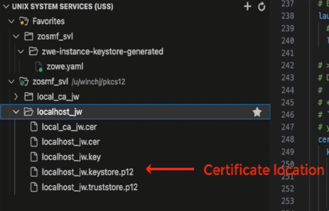

Now let’s take a look at the certificate that you create, which is located in /u/winchj/pkcs12/localhost_jw/localhost_jw.keystore.p12.
The certificate location

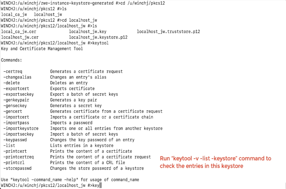

If you want to check the certificate details, you can leverage the keytool command to do so. So first move, you need to navigate to the directory where the certificate is located, /u/winchj/pkcs12/localhost_jw, in the terminal.
Navigate to the directory where the certificate is located
When you arrive here, you can leverage the keytool command to dig into the certificate that we create. So what you need to do is to run keytool -v -list -keystore localhost_jw.keystore.p12 and enter the password.
Run the `keytool` command to check the details
With this command execution, you will see details of this certificate, including the entries, alias name, domain name, IP address, and many other parameters that you set up in the zowe.setup.certificate section in Step 1.

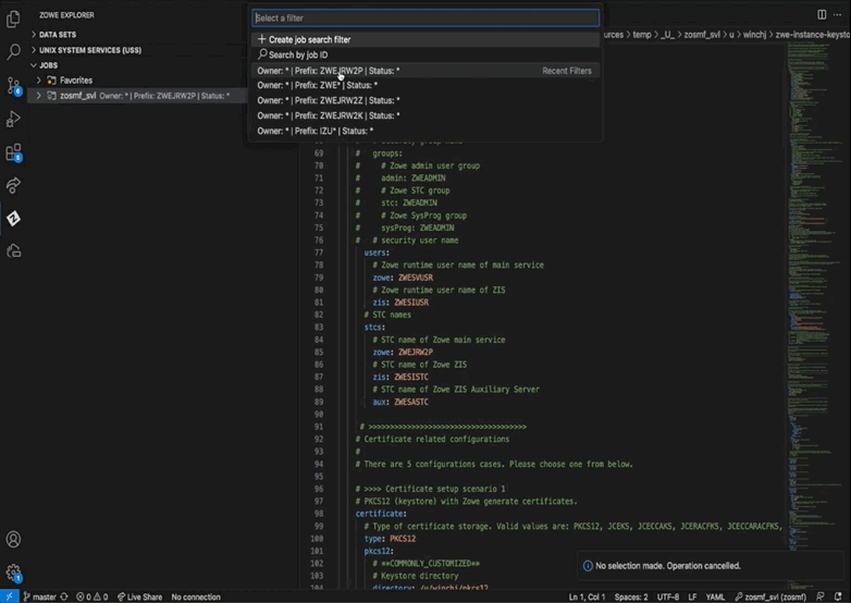

Since the job is on, you can have a look at ZWEJRW2P so that you can make sure the job is started with the certificate you just create.
Check the Zowe main service job
Then let’s check the service status and see if all services are started. You can search the ZWEJRW2P job with the job prefix under the JOBS section. Then you can check the details in ZWEJRW2P:SYSPRINT. Then you can search the keyword “ZWEAM00I” to see the status for each service.
Check the service status

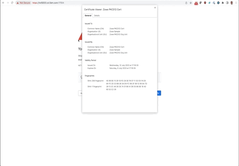

And if you want to double confirm the certificate you are using in this browser, you can click the Not secure button beside the link input field on the top. Then you can see the details of this certificate just as what you set up in the zowe.yaml file in Step 1.
Check the certificate details in your browser
