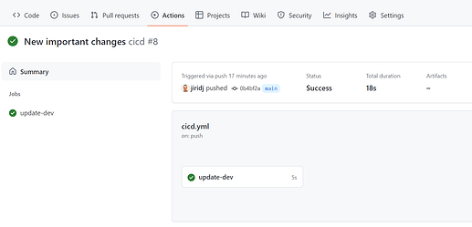

  1. Then your developers go and do their magic, building an awesome API. As part of their CICD pipeline, they will automate building, packaging and deployment of the service code. In a previous post on using GitHub Actions with webMethods API Gateway I have explained how you can automate the registration and promotions of APIs with GitHub workflows. I’ll use a similar approach here, automatically registering the API in webMethods API Gateway as part of the CICD pipeline.
And that ties it all together! If you’d like to see it all in action, here is a quick demonstration that takes just a few minutes!
