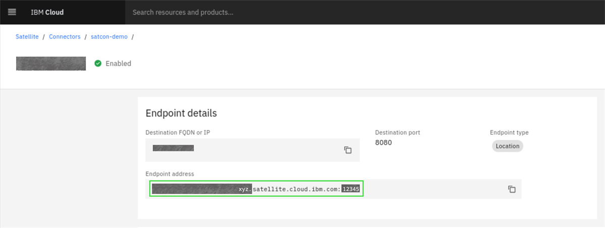

The User endpoint tab of your connector contains the new entry.
Click this User Endpoint to open details page and note the Endpoint address.
connector endpoint details showing the endpoint address needed in the next blog
User endpoint addresses typically look like
xyz.satellite.cloud.ibm.com:12345
Memorize this address for the next blog, it will be required there.
