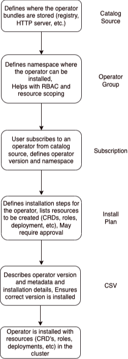

There are a bunch of components with associated functionality which we should know about to know the working of OLM. Lets look into a flow diagram followed by each component and its functionality to understand the working process.
The flow diagram simplifies the overall flow of the OLM components, showing how each component (CatalogSource, OperatorGroup, Subscription, InstallPlan, CSV) interacts sequentially to install and manage operators in a Kubernetes cluster. Each component plays a crucial role in the declarative and automated lifecycle management of operators using OLM.
Step-by-Step Explanation:
  1. CatalogSource:
    - Defines where the operator packages (bundles) are stored, such as in a container registry or an HTTP server.
    - It is the starting point where OLM looks for available operator bundles and metadata.
  2. OperatorGroup:
    - Defines the namespaces where the operator can be installed and provides scoping for RBAC resources.
    - If multiple namespaces are required, the OperatorGroup ensures that operators can access the correct namespaces.
    - It also helps manage shared RBAC permissions across multiple namespaces for the operator.
  3. Subscription:
    Created by the user to subscribe to a specific operator from a CatalogSource.
    - Specifies the operator’s name, desired version, and target namespace for installation.
    - It triggers the creation of an InstallPlan.
  4. InstallPlan:
    - Created automatically by OLM when a Subscription is made.
    - Defines the resources (CRDs, roles, deployments, etc.) that need to be installed to support the operator.
    - It may require manual approval before the resources are applied to the cluster.
  5. ClusterServiceVersion (CSV):
    - Defines the specific version of the operator, including its metadata, CRDs, roles, deployment strategies, and installation details.
    - Ensures that the correct version of the operator is installed and guides OLM in handling operator lifecycle events like upgrades.
  6. Operator Installed:
    - After the InstallPlan is approved and resources are applied, the operator is fully installed and begins running in the cluster.
    - The operator manages resources as described in its CSV and follows its lifecycle from installation to upgrade.
“And that’s it! Now you know what OLM is and how it works.”
