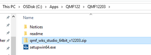

Download the latest fix pack from IBM Fix Central and unzip  it into a directory:
figure 1

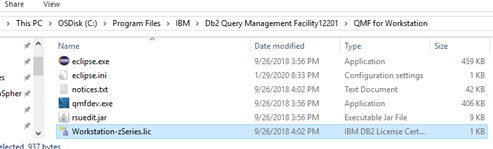

 Choose one machine that has QMF for Workstation already installed and configured.  Go to the directory into which QMF for Workstation was installed and copy the license key:
figure 2

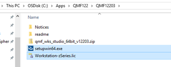

Put that license key in the directory with the setupwinXX.exe
figure 3
If you stop here, then the setupwin64.exe (in this case) will pick up the license key and allow you to do a single install on the new machines. However, these new installs will NOT be configured to connect to  any repositories or databases.

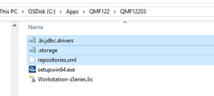

And collect the following three files:
Figure 4
The repoistories.xml has the connection strings to the Repository Storage.
The .storage is OPTIONAL, it has all the user interface config settings like GLOBAL Variables, buttons, menus etc. ONLY include this if you have a standard setup that you wish to rollout.
.bi.jdbc.drivers has the locations of all the JDBC drivers on the master machine. NOTE that these drivers need to be in the SAME location for the target clean machines. That is, if they are in a directory called C:\QMF\Drivers on the master machine then that folder, populated with the same drivers must be on the target machine. The rollout team can most likely make the process create an populate such a folder.
If the drivers are on a shared driver like \\serverx\QMF\Drivers or Z:\QMF\Drivers then there is no need to have the roll out team deliver drivers.
With these files in place, this folder can be delivered to the roll out team to deploy to the new machines.

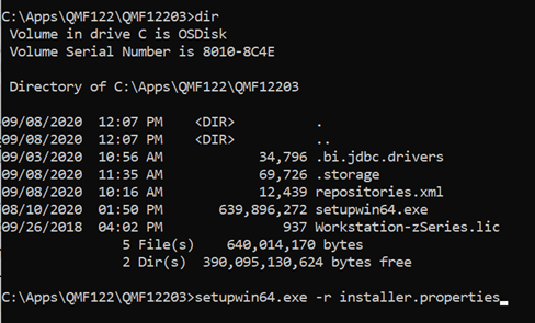

To do this you, run the install one more time on the Master machine, but you run it from a Windows Command line with the parameter -r followed by the file name installer.properties
figure 6
This will walk you through the normal install wizard, but it will record your choices in a file called installer.properties.
Put installer.properties in the same folder as the setupwinXX.exe and the other files.
