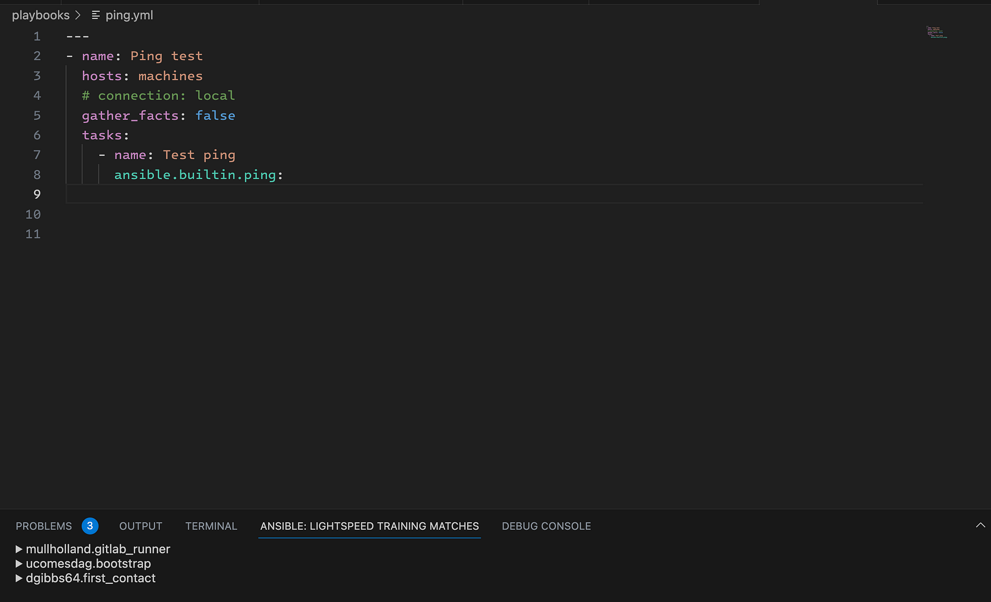

  1. Install the Ansible VSCode extension by Red Hat
  2. Follow the instructions documented here to configure the extension to enable Ansible Lightspeed.
  3. Once successfully installed and configured, you should see a tab at the bottom, as shown in the image below
Ansible Lightspeed training matches
Write the Name of the Task To Generate Ansible

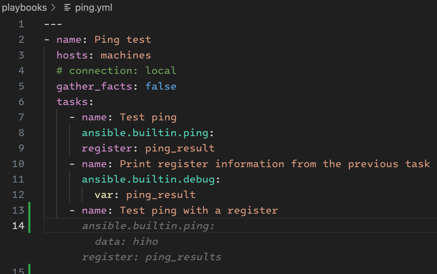

  1. Create a new Ansible playbook called ping.yml.
  2. Add a new Ansible task with a name in plain English, like “Test ping with a register” or “HTTP PUT request to create a new object”
  3. You should see an Ansible module recommendation. Hit Tab, and the code will be inserted. You can further build on the Ansible code that is generated.

Sample Ping Ansible Code
- name: Ping test
hosts: machines
gather_facts: false
tasks:
- name: Test ping
ansible.builtin.ping:
register: ping_result
- name: Print register information from the previous task
ansible.builtin.debug:
var: ping_result
