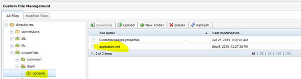

Add this below contents in “application.xml” file and upload the same on IGI
<DESK>
<REALM name="Admin" label="ADMIN" isDefault="true" enableHeaderAuth="true"/>
</DESK>
Take a restart of IGI Application and now you’ll be able to access admin console using SSO .
If some how you observe any issues , navigate to below log file and check error message
Configure IGI - > Manage Server Settings - > Custom File Management -> logs – Console -> desk_console.log
