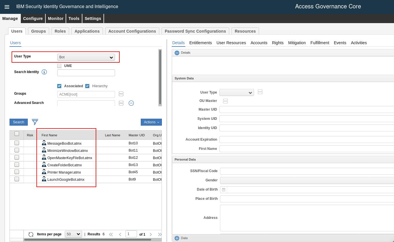

  • This can be a repetitive process, whereby you can use the CSV to update the latest status of the Bots from Automation Anywhere into IGI, be it adding new bots, modifying existing bots OR removing bots.
  • Here's a preview of how you could list down the Bots available in the system, once the BotFeed.csv is successfully reconciled into the system:
SuccessfulBotFeed.jpgFigure 1. Successful Bot Feed

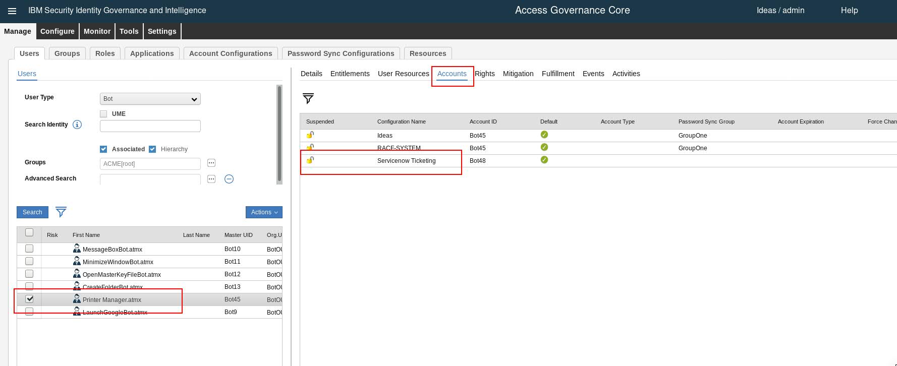

Once Bot data is reconciled into IGI, in the way, prescribed above, you could potentially do every single operation with a Bot, that you would normally do with a user. You could setup BirthRight Accesses to Bots and you can also regulate them.
For e.g. you could select the "Printer Manager" bot and create an account on say a ticketing tool like ServiceNow™, which would entitle this bot, access to the ServiceNow application:
AccountsForBots.jpgFigure 2. Accounts for Bots
Likewise, you can add other entitlements as well. Another point to note is that, in the above example, we are doing the account management / entitlement management using the Admin Console. It is very well possible that we can have workflows which can be opened up for Bot Developers, so that they can request for access to specific Bots on specific applications, per business need. There can be approvals configured in the workflow, to validate and approve the access requests.

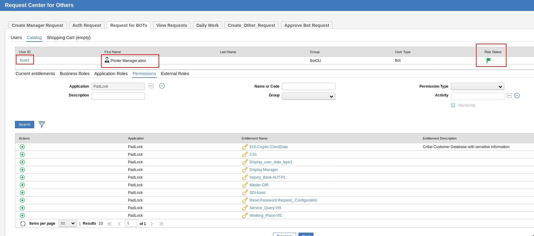

The way, users are subjected to SOD checks, we could very well subject Bots to SOD checks as well.
For e.g. here's a view of the Access Request flow for a Bot, which shows a Green Risk Posture for a given Bot:
GreenRisk.jpgFigure 3. Low Risk Bot.

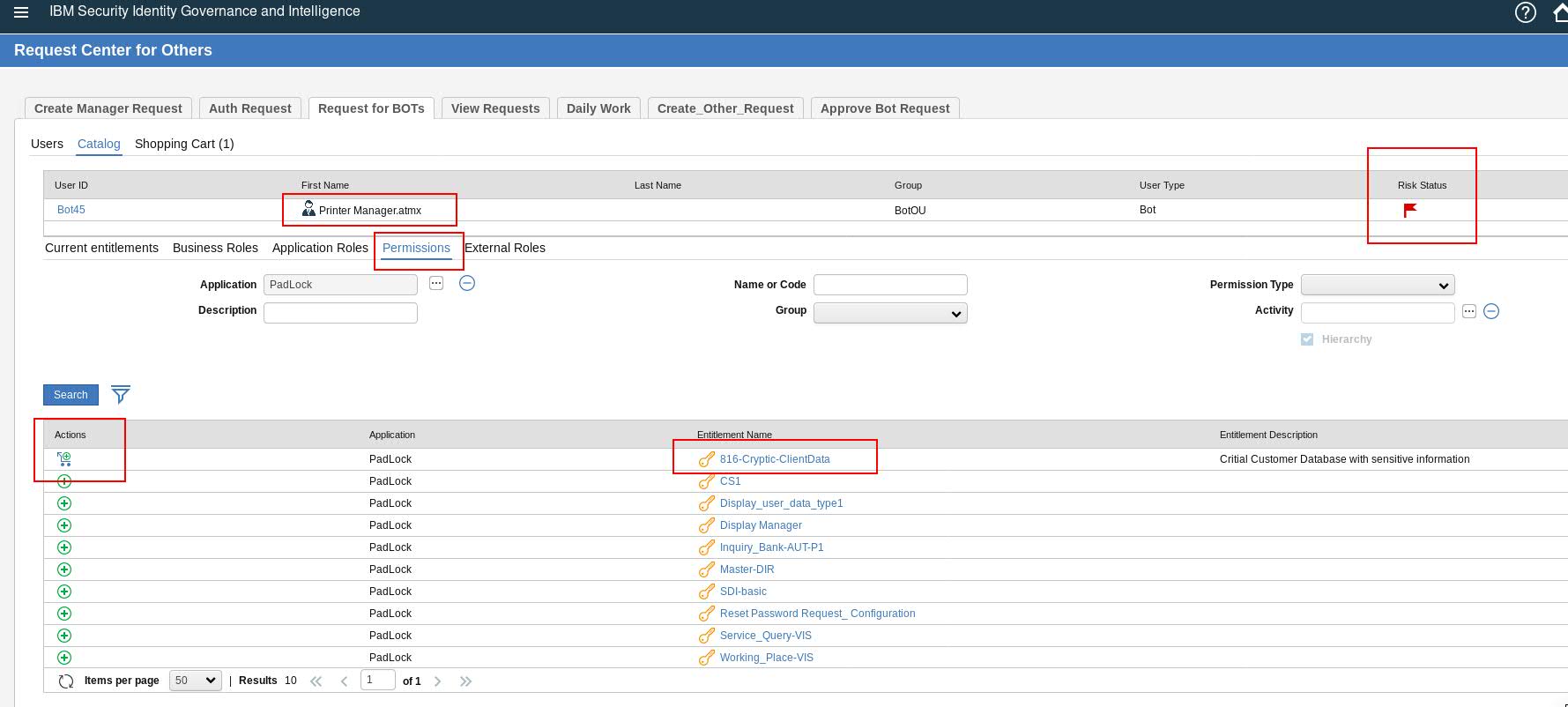

Now, say if I select a sensitive access for that Bot, OR for that matter any access that will create an SoD violation, then the risk posture for that Bot turns Red immediately, as shown below:
RedRisk.jpgFigure 4. Bot with High Risk.

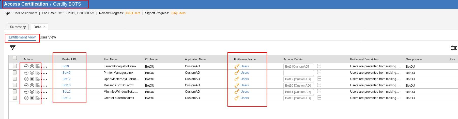

Now that we understand that Bots can have accounts on the end-points, they can have entitlements on the end-point, it becomes imperative that there has to be a periodic review of the Bot entitlements. The way, we drive certification campaigns for Users, we can very well drive certification campaigns for Bots as well. Here's a glimpse of the Entitlement View of a Certification Campaign specifically for certifying the accesses of a given Bot:
BotCertification.jpgFigure 5. Bot Certification.
A reviewer can very well revoke the unwanted entitlements and allow only those entitlements which are needed by business.
