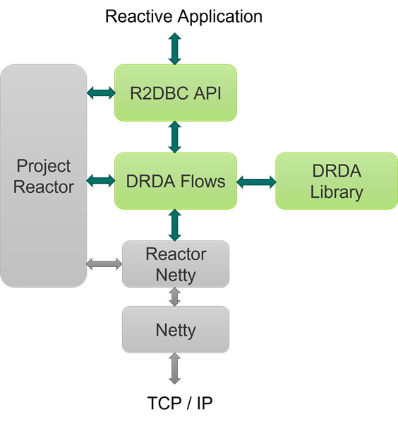

Architecture of this driver is shown below.
IBM Db2 Java Reactive Driver Architecture
The green colored components are part of the Java Reactive Driver. The gray colored components are the third-party frameworks used by the driver.
