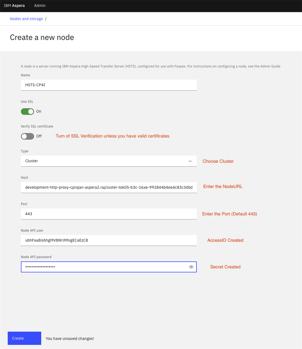

2. Click on "Nodes and Storage" and click on "Create node". Enter details as in the next screenshot.
 Click on create and the node should be created.

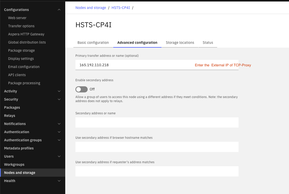

3. Click on the created node and go to the 'Advanced Configuration' tab.
Enter the TCP-Proxy-IP as shown in the screenshot.
Click on Save to save the setting.

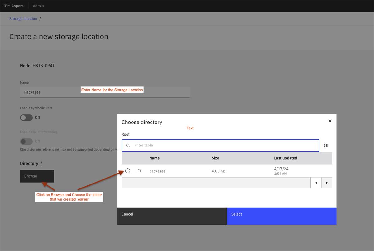

4. Next go to the "Storage Location' tab.
Add a new storage as explained in the next screenshot.

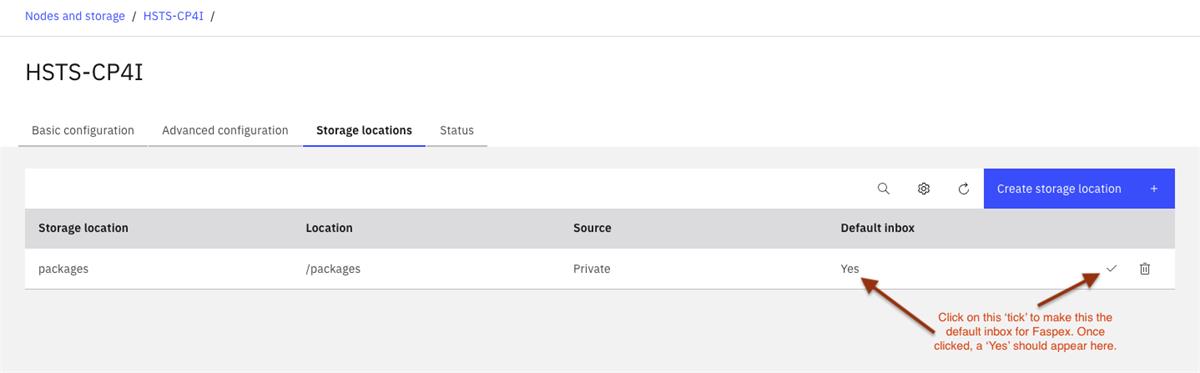

5. Once the storage location has been added, make it as the default inbox for Faspex. Refer to screenshot below.
6. That's it. Now you can start sending packages and the packages will be stored in the HSTS (CP4I). You'll find the packages created in the PVC storage of HSTS.
