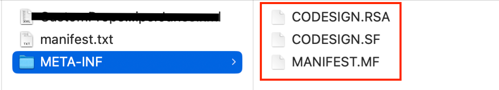

  • Verify app certificate is valid (Developer signed)
Developer Certificates

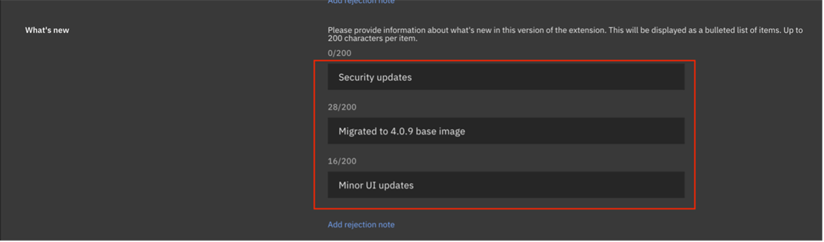

  • Make sure the “What’s New” section is updated and clearly describes the changes.
    • Avoid starting any line with numbers, symbols, or a dash (-) as this may cause the submission to be rejected.
    • By default, the App Exchange automatically adds a dash (-) at the beginning of every new line you enter in this section, so make sure to remove it before submitting.
    • Below is the correct format
What's New content format
