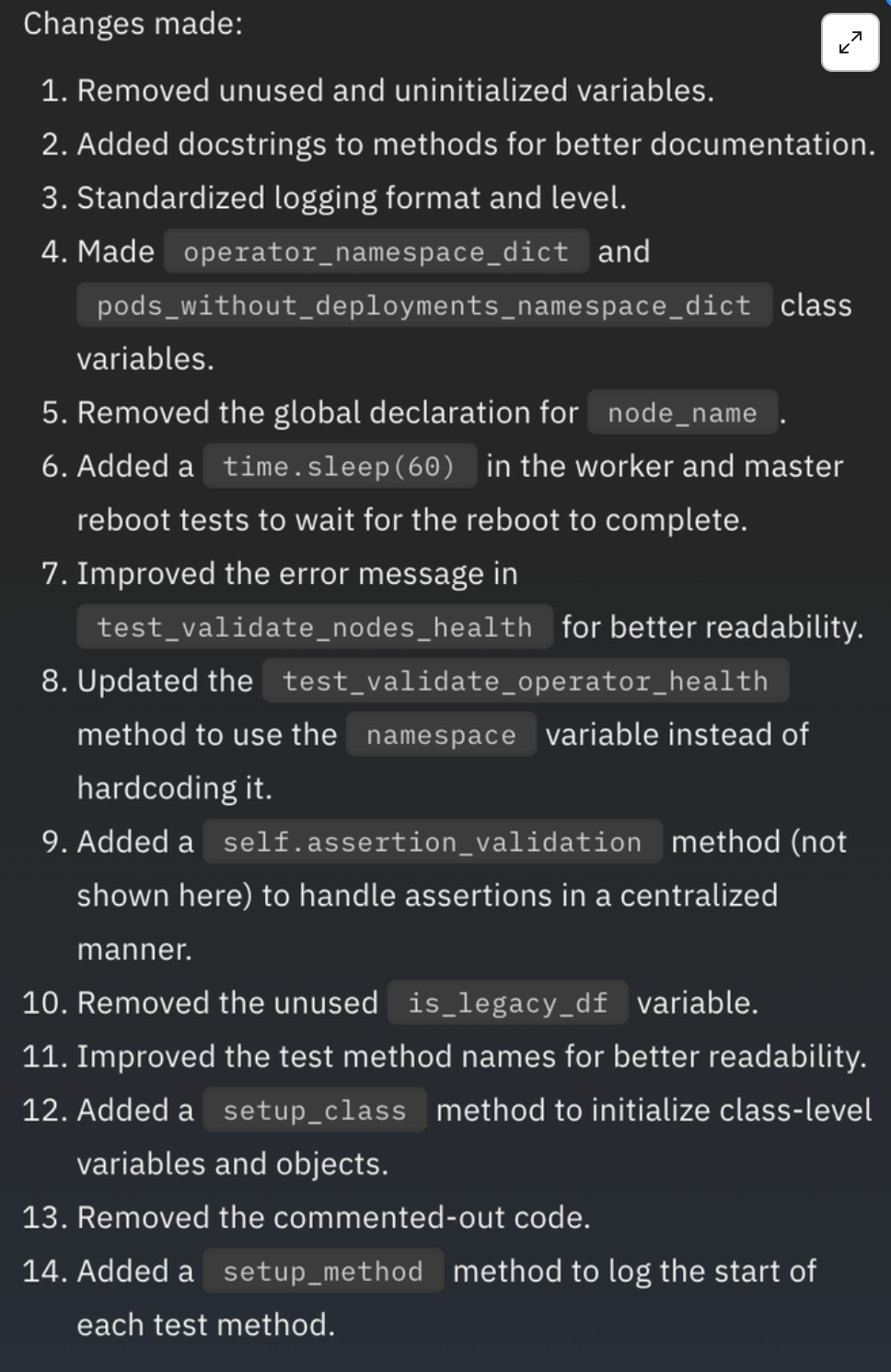

Suggestions provided : It pointed out where the code needs to be refined to align with better coding practices .
  • It gave much cleaner code in-terms of parameter definitions . This helped save reviewer time.
  • It helped remove hard-coding of variable value.
  • Helped improve error message for different failure conditions.
Prompt used: “Refactor Automation code @test_svt_odf_runmco.py”

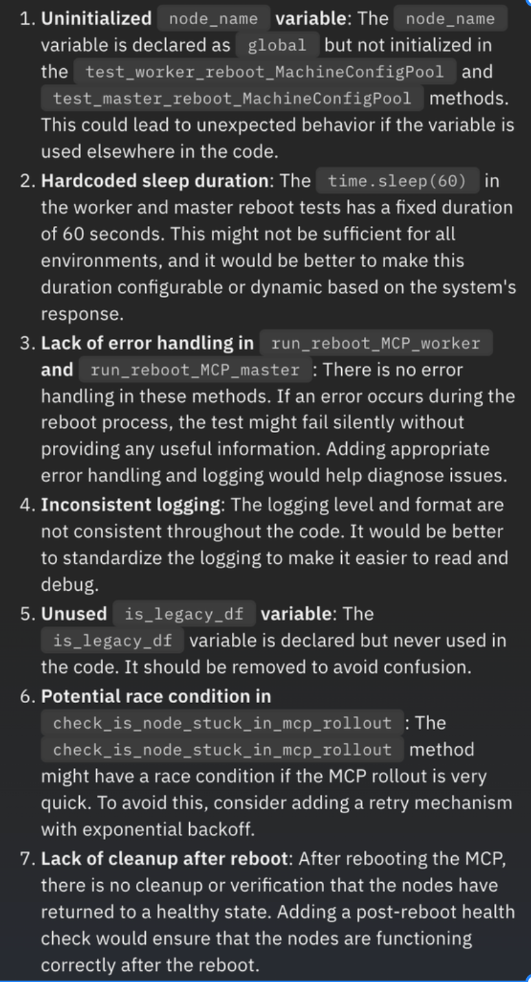

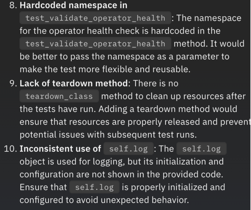

Suggestions provided : It pointed out scenarios where the code will probably fail due to the lack of handling of these cases.
  • Suggested that defining global parameter is bad way of coding: Helped save reviewer time.
  • Pointed out that there is very limited / no error handling in my test functions. Once these error conditions are handled, the code could be tested for different failure conditions
  • Also pointed out there could be possible race conditions in the automation code causing failures.
Prompt used: “Identify potential bugs in the code @test_svt_odf_runmco.py”

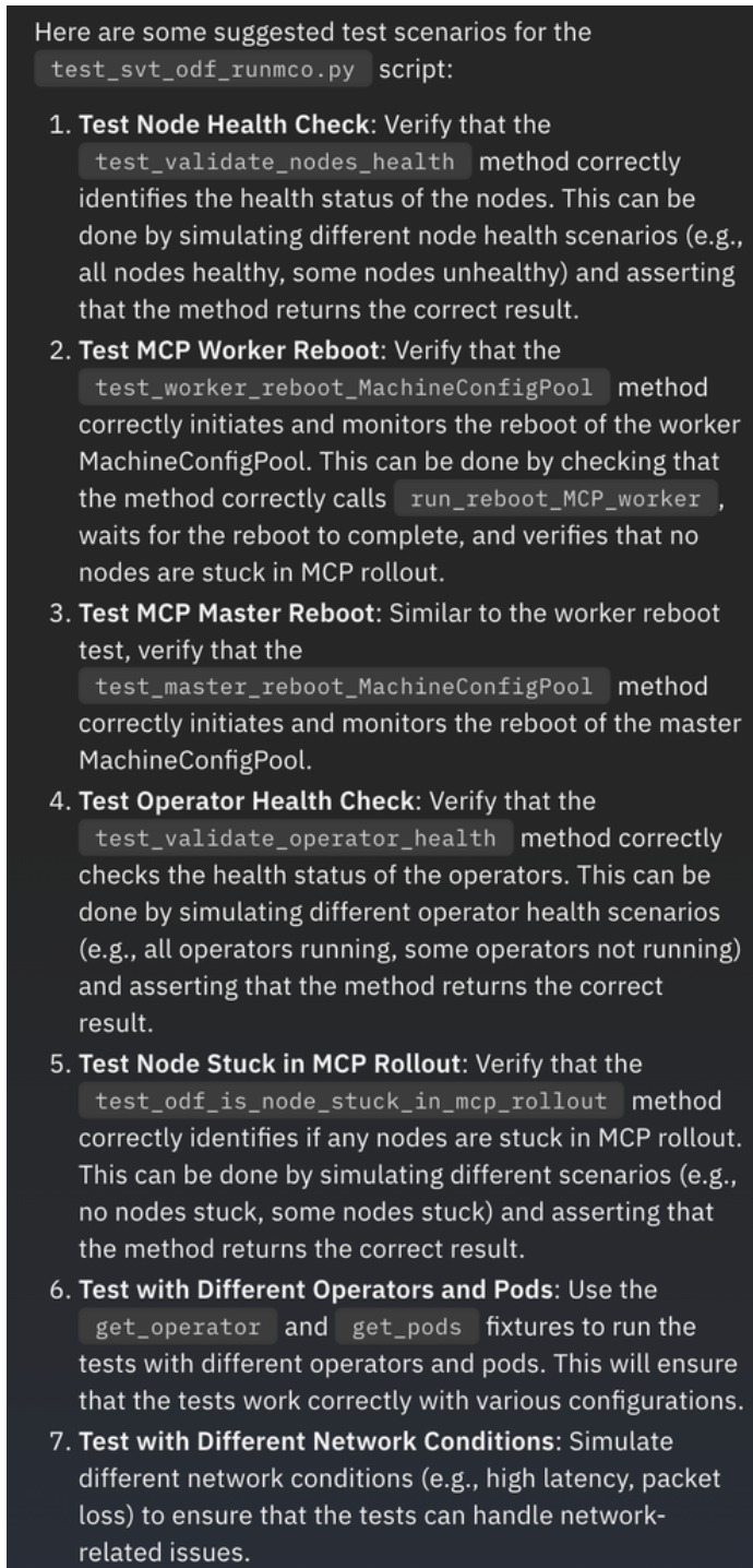

Prompt used: Suggest test scenarios for @test_svt_odf_runmco.py

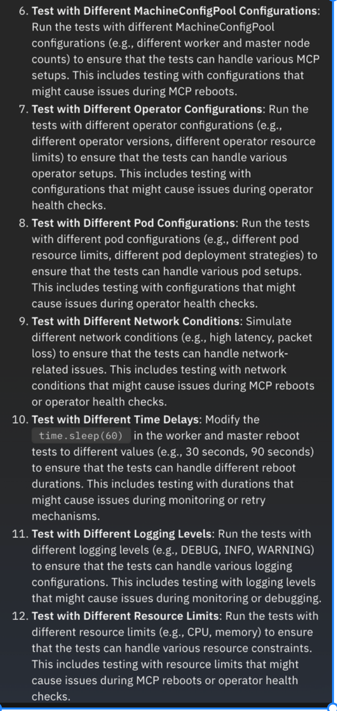

Suggestions provided : It suggested all possible scenarios for which this code needs to be tested.
  • It suggested to test the code for different node health conditions.
  • It suggested to test the code for different operator conditions.
  • It pointed out that only few pods were validated. Instead need to validate with various pod health status.
  • It also asked to validate the code with different number of ODF nodes.
Prompt Used: “Suggest test scenarios for @test_svt_odf_runmco.py”

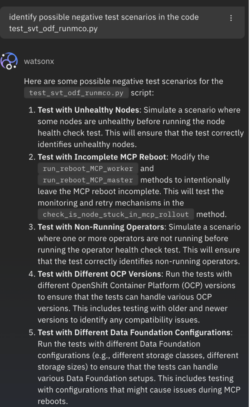

Goal4: Identify possible negative test scenarios in the code test_svt_odf_runmco.py
Automation suite: test_svt_odf_runmco.py
Prompt used: Identify possible negative test scenarios in the code test_svt_odf_runmco.py

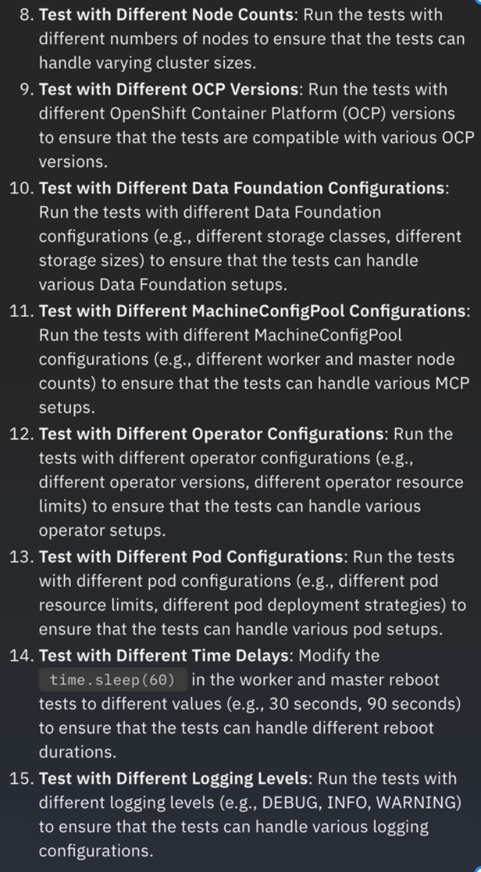

Suggestions provided : It suggested different negative conditions to be tested
  • Test with unhealthy nodes
  • Test with incomplete MCP .
  • Test with Non running operator conditions.
  • Test with different pod deployments
Prompt Used: “Identify possible negative test scenarios in the code test_svt_odf_runmco.py”
