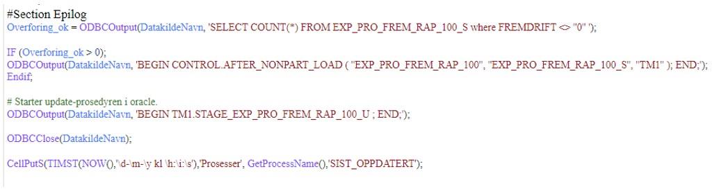

Connection to a store produce in a T1 process.
Planning analytics can run any SQL against a database. This is done by ODBC connection. How to set this up is vel documented.  This an example of how an Epilog could look like

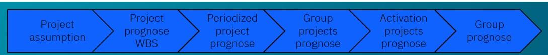

A prognose process consist of many steps. A prerequisite for using this solution is that there are separate processes that can be solved with a process and not a rule. This is an example of my process steps for start collecting data to group prognose reported to the board.

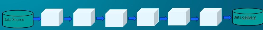

Very often I have seen a both rules and processes moving data between many cubes. This is easy to build but could be difficult to maintain and debug. If there are question like what was transferred during the night or what has been changed since yesterday it is challenges to go through logs.

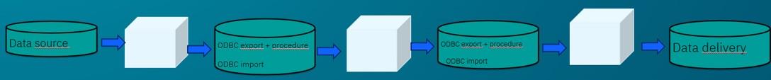

In order to be able to use what the database is good at, we have designed the flow like this
In this scenario a process is handled with Planning Analytics. Instead of built a process within Planning Analytics I am exporting data to the database as T1 process. When doing this I ad database prodcure in the epilog for doing different task like:
  •  Writing data to temp table, if no records the export are not copied to export table and data for last export are kept.
  •  After export we ran a store procedure that do update/insert of data.  That means we never loose any data and knows when a data first time occur in Planning Analytics. This corresponds to SCD2 and SCD1 from the data warehouse method of Kimbal. I have enclosed and example built in Oracle 01.Update/insert
  •           When exporting data, we add a batch number and then last 20 batched are kept in the database. This means we can see which number we transferred last day or day before. We can also see which day did the numbers change to easily find when something wrong happened. This is example 02.insert into
  •           Enrich data for compilations, mapping or other use of data. An export from planning Analytics is often 6 – 8 columns. When exporting we normally we would increase this to 12-14 columns.

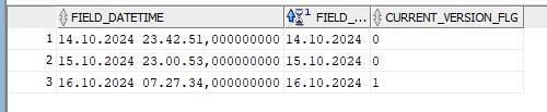

Example 01.Update/insert This will create one new record for each day
First create a table :
select sysdate as FIELD_DATETIME, trunc (sysdate) as FIELD_DATE , '1' as current_version_flg
from dual
Then the procedure:
  CREATE OR REPLACE EDITIONABLE PROCEDURE "TM1"."P_DEMO_UPDATE_INSERT" authid current_user is
begin
update TM1.DEMO_UPDATE_INSERT set current_version_flg = '0'  ;
 MERGE INTO TM1.DEMO_UPDATE_INSERT a
USING (
from dual
)   b
ON ( a.FIELD_DATE = b.FIELD_DATE )
WHEN MATCHED THEN
  UPDATE SET
         a.FIELD_DATETIME = b.FIELD_DATETIME ,   A.CURRENT_VERSION_FLG = B.CURRENT_VERSION_FLG
    WHEN NOT MATCHED THEN
  INSERT (  a.FIELD_DATE, a.FIELD_DATETIME  ,  A.CURRENT_VERSION_FLG   )
  VALUES (  b.FIELD_DATE, b.FIELD_DATETIME  , B.CURRENT_VERSION_FLG  ) ;
  end ;
Field_datetime is SCD1 and Field_date is SCD2. Since table not used for facts SCD keys and to/from dates are not added
